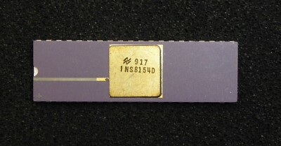

Indeed! I'm waiting on an 8154 to come in for mine, it was found without the one that's supposed to be there.
The 8154 came in back in May, pretty sure it's a fake. I had some time to poke at the board today. It will HALT and JMP 0x0000 just fine. I swapped in some RAM from a known good S-100 board, didn't help. The INS8154 looks like it's been walnut blasted and laser etched, the I/O lines that should be doing serial I/O really don't seem like they are. I may hack a real UART in and get GWMON-80 running for easier poking at it, or just write some test ROMs. Anyway, I ordered a ceramic 8154 from the UK, apparently they were used in a bunch of systems created over there (MK14, Acorn stuff, etc.).

Thanks for the full disassembly! I'd poked a little at the monitor, enough to see that it does indeed use the INS8154 for stack. It looks like the initialization of the 8154 is pretty simple, so I should be seeing the serial output pin go to a TTL level, instead of what I'm currently seeing. More evidence there's an issue with the 8154.
It works now!
I bought another INS8154 from the UK, as mentioned. It came in today, is ceramic just like the listing picture, and does work. There was some corrosion on the legs which wasn't mentioned, but it knocked off with a stainless steel brush, and the pins aren't weak...so I guess I'll take what I can get. Here's the board as currently configured:
I removed the 2K of SRAM as part of debugging the dead INS8154. The Miller ROM monitor doesn't need it, it uses RAM in the 8154 for stack and variables. Here's the dead INS8154:
It's clearly laser marked, and does not match the listing picture. The counterfeit came from eBay, seller ID joma0818, and cost a bloody $37.20 shipped. I bought from a US seller thinking there would be a lower chance of getting a counterfeit, especially since the listing image showed a properly marked NS part. So much for that. This is the one I purchased that did work:
No affiliation with the seller, just apparently counterfeits are a problem for this oddball? So I figured maybe it'd be helpful to have a link to known-good chips.
