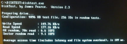

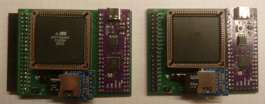

The XTA2SD card in the newest low cost version with a Pi Pico instead of the teensy 4.1.
The size of the card is about 51 x 74 mm, so it can be directly put in the XTA connector ( on the picture left ) or used with the ribbon cable.
Its called the XTA2SDPiC for the Pi Pico ( type C ! ) used.
Further optimizations have been made to minimize electronic parts.
Writing and Reading speed is tested with the James Pearce Disktest, results are shown on the picture.
How do those speeds compare to an old, clunky, physical drive?
Also, I’m sure it’s in one of the previous 20 pages, but how do we order one of these?
