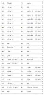

It is very doubtful Conner CP-2024 to be an XTA drive, it is a 16-bit IDE drive. You don't need an XTA adapter of any kind.
Thank you very much for this!
I looked into it and you're right. I will look for other drives now.
The conner CP2024 can be work as XT ( 8bit ) or AT ( 16bit ) , see connector enclosed. If PIN 44 is grounded it works as XT.
