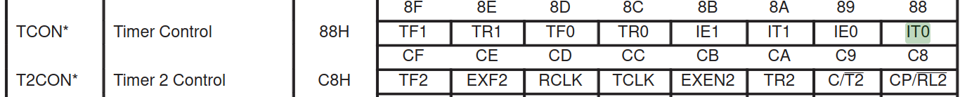

Example: TCON as a whole register can be address as a single byte at internal address 88H
The single bit IT0 can be addressed by the SETB or CLR commands also at 88H
IE0 is one bit further so it will be bit addressable at 89H, IT1 will be at bit address 8AH etc etc.
T2CON is adressed the same:
Whole register is byte addressable at internal address C8H and all the single bits are bit addressable from C8H to CFH
From the datasheet:

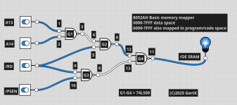

And there is a separation between data and code memory (selected by the /PSEN and /RD pins)
I have explicitly selected the memory regions so that there is 32k SRAM data memory from 0000-7FFF and my external ROM lives in code memory from 2000-7FFF with selectable 16k banks from 8000-BFFF which are accesible from both code and data space. At the top I have 8 kB of shared code and data space E000-FFFF.
You can only execute code from the memory regions which are output enabled by /PSEN
You could try and combine the signals from /PSEN en /RD on the lower part (so it would be possible to execute code from there) but the Basic has provisions for extending and replacing certain functions by placing certain values and code at 2000... and 4000... so that may create a conflict.
For testing you could combine the /PSEN and /RD with two diodes: one cathode to /PSEN and other cathode to /RD and anodes connected together to /OE of your SRAM and a pullup resistor from /OE to +5V

I have been chatting with Gemini about a simple memory mapper which would make it possible to test some machine code programs and it gave me some clues but alas not the exact right answer. Still together we came up with this:
With just a single 74LS00 IC it maps the 32 kB SRAM into the standard data region 0000h-7FFFh but the last 8 kByte from 6000h-7FFFh is also accessible as program/code memory from 6000h-7FFFh (so no conflicts with the program/code 2000/4000 area) You can lower MTOP to protect this region from Basic overwriting it.
You just have to disconnect the /OE line of the SRAM and connect it to /OE of this circuit. Inputs are /PSEN, /RD, A13 and A14 (and power of course).
I tested the circuit in the Logic Simulator at logic.ly But no warranty:p
