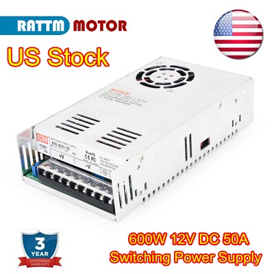

I don't know if anyone has come across this model of 12v supply before, but it is adjustable from 0 to 12v
and it works fine as an 8v supply for S-100 systems as an alternative for the monster linear non-regulated
supplies normally in the system
MZMW MS-600-12
MZMW, because MW was already taken.
A Mean-Well RSP-320-7.5 is $53.20 at DigiKey. It is rated at 40A at 7.5V, with an adjustment range of 6V - 9V.
215*115*30mm vs. 215*115*50mm of the MZMW MS-600-12.
Working temperature of -30 ℃ ~ +70 ℃ vs -10 ℃ ~ +50 ℃ of the MZMW MS-600-12
I wonder how the construction quality of the two brands compare. Looks like the adjustment range of Mean-Well 12V supplies doesn't go down as far as 8V, and they have fewer models with 7.5V outputs than 5V and 12V output models. Their 7.5V models with higher power ratings than the RSP-320-7.5 are a lot more expensive.

I'm using a Mean Well S-150-9 on a 5v only backplane (no +/-12 required). It is easily adjustable to +8v and works very well. Specs. say it is capable of 16.7 A output. Way more than what I require.

A big advantage of using switch mode power supplies is that there is minimal 50/60 Hz ripple at the output. This means you can run the 8V rail at say 7V which significantly reduces temperature of the onboard regulators.
That is true.
In many cases, in certain applications, where noise was an issue, oscilloscopes for example, the power supply design M/O was to have switching regulators initially. This got the output voltage stable, even with line fluctuations, so that this voltage could be fed into final analog regulators, with minimal heat dissipation in those regualtors.
In most cases, the DC supply in vintage S-100 computers had to be kept in the 8.5 to 11V range, prior to the 5V regulators on the boards, because they require a minimum of 7.5V input and line voltage fluctuations had to be allowed for.
