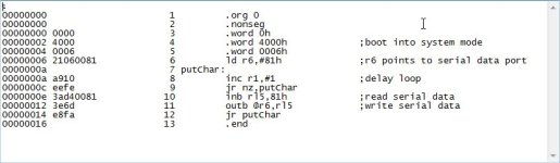

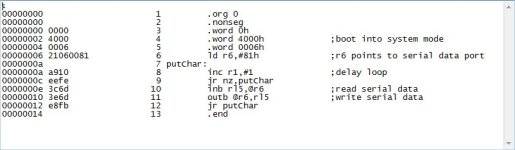

I’ve added a pair of RAM to my z8002 prototypes. The memory map is ROM from 0-$FF, RAM from $100-$FFFF. Serial port is in I/O space $81 data, $83 status. I set aside 256 bytes in CPLD for ROM space, but actual ROM size is limited to 128 bytes. Most test programs fit in 64 or 32 bytes. CPLD utilization is around 90%, depending on size of ROM. Schematic of CPLD is included.
The ‘echo’ program is a tiny program that delays few hundred milliseconds, reads the serial port, then echos back what it read, and repeat. The program works when serial input is INB RL5,@R6, but put out a constant character with INB RL5,81h. That constant character remains the same regardless of what I type.
