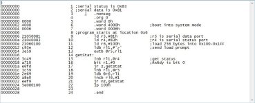

Intriguing. One other thing I'm curious about. Why are you addressing the OUTB via the R6 register? Didn't direct addressing work the same way as INB? The code is correct in both cases.
I can do OUT 81h,R5 correctly, however OUTB 81h,RL5 does not work, but OUTB @R6,RL5 works correctly. So I’m now switched to IN and OUT via a register.
Now I’ve overcame the IN/OUT hurdle, I’ve a working serial loader in CPLD ROM that loads and runs a 256-byte program in RAM. Now I can run programs without repeatedly reprogramming the CPLD. Ran and passed memory diagnostics, so I’m ready to write a monitor.

Something doesn't add up here. The instructions OUT 81h,R5; OUTB @R6,RL5 work, but OUTB 81h, RL5 does not. I suspect that the same effect applies to the IN instruction? Does the CPLD have any connection to the A0 line for I/O operations?
I am finding it difficult to understand that Zilog would release a device that had a fairly fundamental bug in the I/O instructions. There are not too many of them, so the validation suite should cover them all (plus all of their addressing modes). I am, therefore, suspecting a timing-related issue (the two addressing modes having slightly different timings).
I am, however, having a little bit of trouble understanding your CPLD logic and assembler code.
The assembler code is not 'spinning' on the UART status bits (a - to make sure the receiver has received a character and b - to make sure the transmitter is free). I understand that you have the software delay before inputting and outputting the data byte - but (for real practical purposes) the UART status bits should be used.
I am also trying to understand the logic around the UART receiver with the DataReady looped back to the RdData pin and the subsequent D flip-flop on the data output from the UART.
Just trying to understand your design...
Did you actually see the correct address and status going out on the Z8k's AD and control buses at the appropriate time?

I didn't "spin" on UART status bit because IN instruction is not working using direct addressing, so I can't read the status bit with IN instruction. When I did memory map of the receiver, I was able to spin correctly on UART status bit when UART status is accessed as memory.
The DataReady looped back to RdData is for moving data from serial port's internal register to data buffer thus reset the serial receiver state machine to accept next serial input. This implements the "double buffer" of serial receiver. I have used this particular serial port design for 5-6 years for different processors, so I'm fairly confident the serial Rx and Tx are working properly, but anything can go wrong, as any practicing engineer knows.
I've revised the CPLD design to correct a problem with RAM access. The current CPLD design has a serial loader in ROM that loads and runs 256-byte program in RAM. It is working well using register-indirect access of the serial port.
Bill

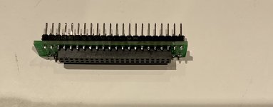

Next function I want to add is a CF interface to support CP/M. I have designed a solderless breadboard-to-2mm-CF adapter so I’ll use it to interface to CF on my prototype.
I plan to change CPLD ROM so it loads and runs 512 bytes bootstrap code from master boot record of the CF disk which, in turn, loads either a monitor or an OS like CP/M.
Bill

I am very curious about your progress with CF, as I have not yet begun preparations to implement this solution in my project (for obvious reasons described earlier).
The CF interface is at top right of the picture. Embarrassingly, I have to wire the circuit twice because I’ve accidentally cut the VCC wire to a RAM the first time. The board actually kinda work with RAM power cut, but will not pass diagnostic, so of course I thought the newly added CF circuit was to blame. Torn everything down only to find the cut RAM wire! At least wiring up CF interface the second time around is much faster.
I worried quite a bit about signal integrity of 16-bit CF interface, so all 16 data lines are sourced terminated with 100 ohm resistor. CF read line has the 100ohm/100pF filter, and I’ll start with slowest Cisco 64MB disk. CPLD for CF addition is done; CPLD resource utilization is 86%; it powered up without smoke and passed diagnostic. I’m ready to write CF test software. Fingers and toes crossed!
Bill
