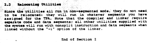

I do believe that the CP/M-8000 TPA space can be further split into code (I) and data (D) spaces to further increase the size of programs that can be executed. However, I believe this to require a switch at link time. Although I think that most programs are shipped in relocatable format?

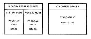

The Z8001/2 can use the N/S signal to differentiate between two separate 64K areas, but then you can use the status lines to further partition this into code, data and stack. Not sure how many of these are actually supported by CP/M-8000 though. Perhaps just system mode (all combined) = 64K and then 64K for each of the normal mode program and combined data/stack?
Last time I looked at the CP/M-8000 System Guide I confused myself!
EDIT1: Page 4-31 of http://www.cpm.z80.de/randyfiles/DRI/CPM8000_systemGuide.pdf is interesting. It maps logical to physical addresses using 'space codes' and can be used in a non-segmented TPA mode. How is another matter...
EDIT2: After reading the CP/M-8000 manuals again it would appear as though the SYSTEM MODE combines things together into a single 64K segment - so splitting this region into separate 64K areas is not sensible. However, the TPA supports separate I and D space, so 64K of memory can be allocated to an 'I' area; and a separate 64K of memory can be allocated to a separate 'D' area. This behaviour is determined by the linker -i option. However, there seems to be a statement I found that certain [larger] utilities REQUIRE separate I and D space for running within the TPA. Unfortunately, I can't find it again...
EDIT3: I found it again in http://www.cpm.z80.de/randyfiles/DRI/CPM8000_systemGuide.pdf on page 2-1.

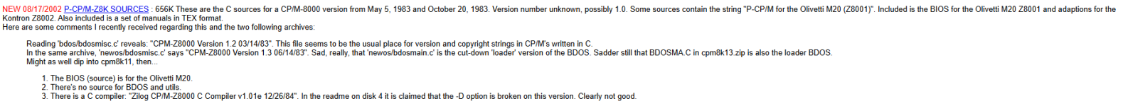

The full sources for CP/M-8000 are available.
I will post a link when I get into work (just running out of the house at the moment).
The sources are here: http://www.cpm.z80.de/source.html.
I went for:
This appears to be the 'latest' (1.3).
However, there doesn't appear to be the sources for the assembler, C compiler or some of the other utilities. Some of the other disks contain some of the other utilities (but perhaps not the source). I fear we may be into making a 'frankenCP/M' if we are not careful.
Perhaps better to take one of the complete distribution disks and generate a new BIOS?
There is an Olivetti M20 emulator around, so that may be the best route to building the executable?
This is where we need @Dwight Elvey to chime in (being the expert)...
EDIT: Full sources are here:
I am currently trying to locate the Kontron Z8002 adaptions...
EDIT: They seem to be in the 'newos' directory with a numeral '2' just before the file extension [period] separator (so biosboot2.z8k instead of biosboot.z8k). The number of 'adaptions' seem fairly extensive, so (I assume) using a 'standard' CP/M-8000 (designed for a Z8001) looks less likely to work...

Ya the Z8002 is slightly difference : No segmentation pointers and no Segment/Bus error signal line. The program status memory map is a little different as well. So on the Onyx Z8002 model computers they use there
own MMU and segment bus error logic. (In a nut shell/in short).

If you are using 256K drams without MMU you could still add a bit more memory by decoding the Stack and Data spaces into separate 64K blocks as well but the support for this will have to added to the OS to make good use of it.
The standard CP/M8000 OS needs 128K of memory for operation unless you want to cut of the compatibility to run existing programs and then you you are going to to patch and recompile code in order to run it on the system.

The Z8002 can directly access 128K of RAM if you split
the instruction and data spaces. The only disadvantage
of doing this is that you'd need a way to map the instruction
memory into data space to load the RAM and then switch
it back to the 128K mode to run the code.
The M20 does this but handles it but using different segments.
One could do this with a bank switching trick on the Z8002.
