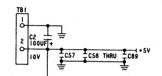

+3V is technically enough (TTL signal HIGH) - but I would expect the HIGH signal levels to be higher than that though...
Can you just measure the voltage at TB1 - making sure to get the connections correct - TB1/1 0V and TB1/2 +5V.
