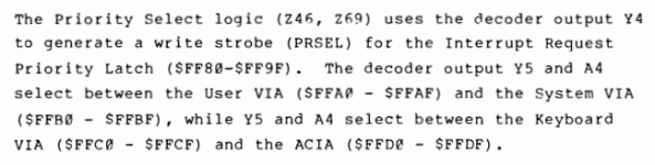

The I/O ROM is selected from $F000 to $FFFF. The I/O is located at:
So pretty much from $FF80 upwards (but NOT overlapping the reset, NMI, SWI vectors that are right at the top of memory).
EDIT: There is an error in the last bit of the text above. The latter reference to 'Y5' should be 'Y6'.
The address $FFEx and $FFFx (effectively the unused Y7 output from Z44) are allocated to the I/O ROM itself - and are used by the 6502 CPU to access the restart vectors.
