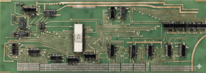

So I asked Gemini AI if there was a way to take the photo of the original Altair prototype board and clear it up. I was expecting it to just tell me 'you need a better photo' or give me tips on how it might be done, but instead it just generated this.
Definitely some errors, but it's not way off. I'm impressed!

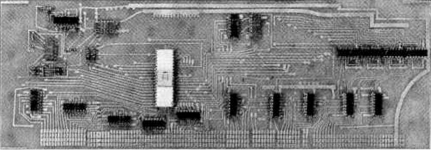

That is interesting. Can you post the image that you gave to the AI as well, so we can see what it managed to do.
Here's the original. Bear in mind, I had to do some corrections with this as it was shot at an angle. I may not be accurate.
I'm trying to figure out what is a pad with a thru hole vs just a pad. It looks like the bottom area is just pads which I think they attached their ribbon cables to. It looks very hastily put together, even the cutting is kind of off kilter. It just looks kind of bizarre to me, like the 'comb' on that the lower of the two thick traces there. I'm thinking it doesn't conform to the final schematic at all.
A pad with a thru hole invariably has a track on the other side of the PCB.
Was that what you were asking?
What I meant was, I can't tell which pads in the picture have thru holes and which ones don't. I think the mass of them at the bottom of this PCB don't possibly - I think they just soldered flat ribbon cable wires to them? Hard to tell. Wish there were better photos!
I would hazard a guess that this is a 'sea' of pads, and that the top pads that have PCB tracks attached to them may have vertical tracks linking the pads together vertically.
This would mean that you could solder multiple connections (up to 4) to the pads that are attached to IC pins on the board.
Now what they did with the other pads is another question (as to whether there are PCB tracks on the reverse side of the PCB)...
