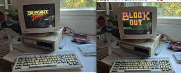

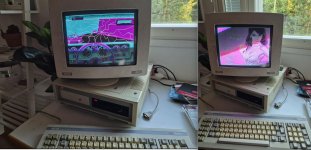

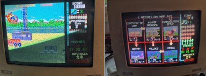

Assembled the unit and tested some media I found on some old untested 360k floppies
I had lying around. Colors and graphics work great with the monitor, I'm very pleased with it.
All internal brackets were gone, I had to improvise something to hold the floppy drive in place.
Also missing back / top lid above the extension cards.
Added a reset button (+5V -> cpu pin 21), but I think I will add 10k resistor to that before using it much.
Also put 4x AA batteries, but date and time settings will still reset every time the Amstrad reboots?
heh, Amstrad refuses year 26 anyway.
Hard drive solution is still not implemented, but something will have to be done about it.
It's very inconvenient to use like this. And super slow, for example that Operation wolf I tried,
it's in two (or three) floppies, and asked to change floppy 4-5 times before the game could start :).
Good old times. Lovely machine!
