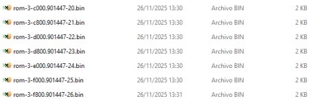

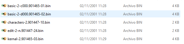

I am a bit confused about you using a 2532 EPROM in H4 for the Kernal ROM.
Assuming I have chosen the correct schematics, each ROM is a 2K device not a 4K device...

I'm also a bit confused about the EPROMs... As I understand it, it's possible to install the 2k EPROM group (image attached) or the 4k EPROM group (image attached), since they are selected in pairs (H1-H5, H2-H6, and H4-H7, leaving H3 as a single 2k pin), but I'm not convinced about either option.
Before I started replacing the ICs, I installed the 2k EPROMs and all I saw on the screen was garbage... I haven't tried them again since the replacements.
I'll try again tomorrow with the 2K EPROMs and let you know.

Actually, using a 4K device in H4 appears to work! I hadn't noticed this before.
