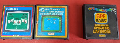

Then, I tried a couple of game cartridges that I bought separately off of eBay, Blackjack and UFO. The basic cartridge will only work in the imagination machine.
Okay, everything great so far (cleanup still tbd)!

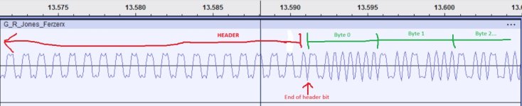

A 1 bit is a single cycle at 1KHz (e.g. 1ms). A 0 bit is a single cycle at 2KHz (e.g. 500us). Thus the baud rate is roughly 1500, but obviously data dependent.
As the header consists of a continuous 1KHz tone (all 1 bits), followed by a single cycle at 2KHz (one 0 bit), this is pretty easy to mess up. Any tiny glitch in the header will cause the load to start too soon, which will completely mess things up. You will see this immediately as garbage loaded on the screen (so it is pretty easy to detect). No need to wait until the checksum check at the end. You avoid most of this by waiting until you hear the header tone before hitting the second "return" after issuing the cload. No need to rush, as you have 11s of header.

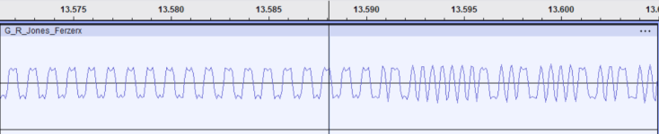

First of all, here is an example of relatively clean WAV file (left channel only), showing the end of the header (1KHz steady tone) and beginning of the screen data. You see the stream of 1 bits through around 13.590s, then the one 0 bit (a single cycle of 2KHz), following immediately by the stream of bits for the screen. This is pretty typical of what the WAV data looks like (and it clearly isn't perfect). Obviously, the cleaner the WAV file, the better the chances it will load correctly.

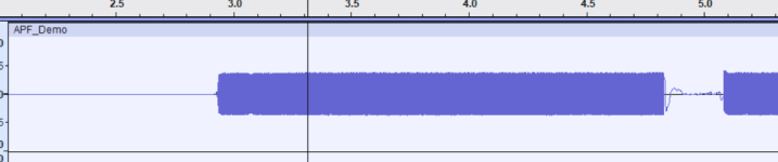

Here the header is corrupted mid-stream (within the 11s window), note the complete drop-out between 4.7s and 5.1s. However, as long as some header remains, this can be easily cut out or regenerated:

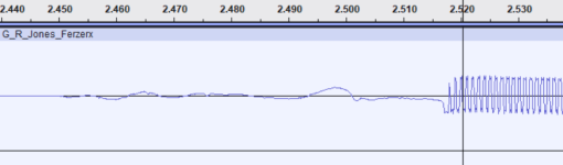

Here the header is corrupted right at the start, likely tricking cload into starting the data load too early. Again, the solution is to either delete or force silence in this section. Or just wait a bit before hitting the second return:

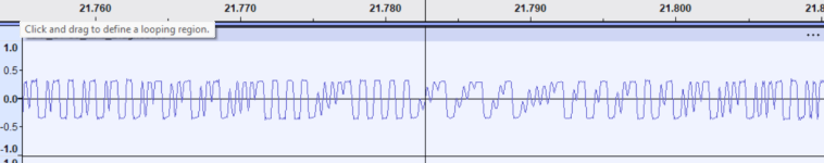

And here is an example of a supposedly good WAV file, but with a dropout section in the middle of the file. You can clearly see the malformed data, and it might even be recoverable with some processing or even hand editing (I tried and gave up). For this file, I happened to find another copy among the Yahoo Group archives which wasn't corrupted. However, for many files, I only could find one copy among the sources I know of.
This brings up the problem I mentioned at the beginning. Once these files (and original cassettes) are gone, it will be a loss for us all.
