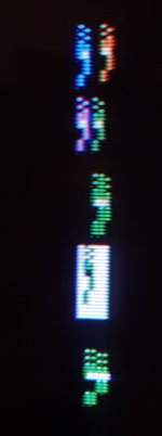

Here are images from that low resolution television. It has a little 5" color CRT with just enough of a fine pitch on the mask to make 160 horizontal lines of detail work. Despite it being a composite signal input, this TV does not show dot crawl on those signals that would make it present.
I have two pictures, one with:
HPLOT X, Y: HPLOT X+2, Y
and one with:
HPLOT X, Y TO X+2, Y
This TV basically blends pixels together giving one close to 140 pixels of resolution.
The three pixel solution (x, y to x+2, y) looks different than the two pixel solution does.
The colors stay more true to form with two set pixels separated by an unset pixel. Basically, one gets blue or orange depending on the coordinates.

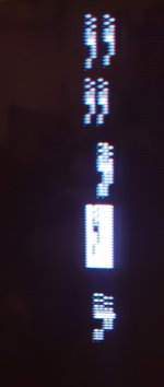

On the high resolution TV, I present a quick color study along side a run of the circle program using the two set pixel solution rather than the 3 set pixel one.
The color study shows an ability to add color detail at twice the resolution one would expect of a 140 pixel machine.
The same shape is drawn using 140 pixel resolution just to compare. Note the inverted one too.
Artifact graphics on this machine are both weird and wonderful at the same time. I love the art possible.
Please ignore the little micro pixels you see right below the real ones. That is a display artifact unique to my particular display type. Those have nothing to do with apple graphics.
