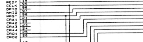

I did see that and the pictures should generally help.

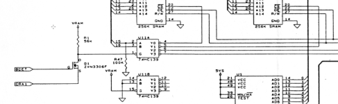

It looks like the 4 lines from the DIP chip are CRA1-CRA4. CRA2-4 are not connected normally. This makes some sense (4 banks of 128K)
It is also picking up OA15 and OA16 off the memory card connector.
It is mentioned that all of the RAM was removed and replaced with the single chip, so likely decoding CRA1-CRA4 into A15-A18.
The fet and resistors appear to be replacing the Battery detect (BDECT) and probably CRA1-CRA4 are OR'd to generate the chip select. Replacing this circuit below:
