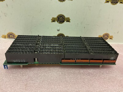

So found a source for a BA-23 chassis + PSU working from a local(ish) seller
They are asking $700... (500 pounds UK + postage) next day delivery (which is nice).
I am desperate.... as these are incredibly hard to get hold of... and I can then QBUS card 'it up' to a decent PDP-11 standard quite cheaply (such as an 11/23).
Finally then will have my (Micro)PDP-11 after years....
Question is, is it a fair price? I might have to buy anyhow as it could literally take years to get one otherwise in the UK, still would like to know peoples opinions.
It seems a little expensive, you can get the raw backplane for a lot less....
but then thats everything....
Thanks, yes I saw these and considered that idea, would need to import from US so add 30%.... crazy import duties/tax here in UK, and returns wouldn't be simple, and I'd lose a lot.
However I'd still need a case (so the QBUS cards could be mounted securely) and PSU and cables, and therefore decided that it would be far easier to find a BA-23 and only then need to worry about buying and testing QBUS cards.
Initially would just get a cheap CPU card like an 11/03, some memory and a serial card. After that could get a Disk controller (likely a more expensive QBUS SCSI card). Start with something like RT-11.

I am just about to pull the trigger and purchase the BA-23 though - I am not sure if I also need a control panel? I expect a MicroPDP11 control panel will also not be cheap.
As I understand for checking the backplane/power etc I'll just need a LSI/PDP QBUS CPU and a QBUS serial card (and maybe some RAM). I did hear some cards actually have limited memory+serial port on them so could all be one (dual) card but haven't found which models yet (if any).
The microPDP11 control panel usually just has a couple of LEDs on the front and 2, 4 or 6 buttons for controlling the disk drives etc. (depending upon which model you are purchasing).
There are all sorts of options for PDP-11 CPUs, so it is all a matter of what is available and what your preference is.
Of course, there are also third-party CPUs (e.g. Mentec).
You're probably thinking of the MXV11-B (M7195) Multi-function Option Module, which includes 128KB RAM, two ASYNC I/O, RTC, and a pair of 28-pin ROM sockets.
