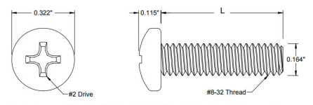

I also see that the quarter-turn fasteners appear to be pan-head sitting more-or-less flush to the outer panel face rather than the elevated spring-loaded types illustrated on page 12 of "BA11-F_RevN_Engineering_Drawings_Mar76.pdf".

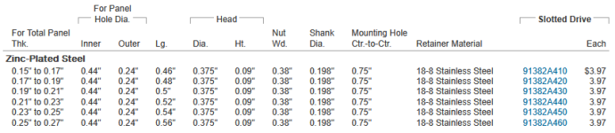

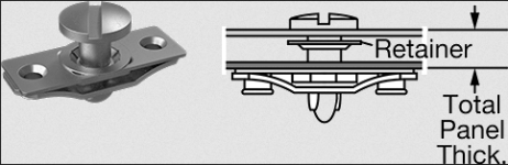

Retained quarter-turn panel fasteners are a problem. McMaster-Carr lists "Rounded Head Quarter-Turn Captive Panel Screws with Rivet-Mount Nut" fasteners here: https://www.mcmaster.com/products/quarter-turn-fasteners/ Example:
"Rivet-mount nuts can be riveted into thin panels for a flush fit. They can be mounted without spaces between the panels. A quarter-turn locks and releases access panels, doors, and covers. The screw is held to the outer panel by a retainer. Rivets not included. Install with 3/32" rivets in steel and 1/8" rivets in plastic. Length is measured from under the screw head."
Has anyone explored this path to deal with missing DEC hardware?
"DZUS" seems to be well-known branding term for a similar style as used for fastening motorcycle cowlings. I wonder if those would fit the existing BA11-F receptacles that are riveted to the chassis.
