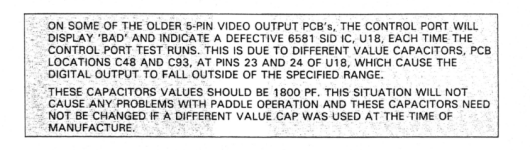

Hmmm the 586220 diagnostic manual says this..
I have a 250425 myself with EXACT same error using harness/diagnostic cartridge...but I dont have the 5-PIN video out..but have the mentioned capacitors .
