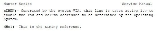

Main problem I think is the no activity at that KBD-IC at output PA0-7.
As the nKBEN signal is not activated by a key-press or by 6522. (see attached)
CA2 does activate by a keypress though.

That nKBEN signal Must go Low after CPU indicates an activity due to CA2, as that is working if there is a key stroke.
nKBEN does not activate to Low.
So that way I thought , must be something with the Boot process that does not finish.

KBEN is only lowered on an interrupt from the keyboard controller to take it out of free run, if the 6522 has been setup to interrupt from CA2 so is IRQ being asserted (I would imagine not) when a key is pressed ?

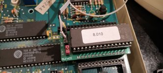

Put in a New MOS with new version (with hold 3 versions slected with a switch)
Is of no help.
Sometimes I get a scrambled screen.

Sounds like one of the custom IC's.
It might be worth removing the mem controller and see if the CPU and IO controller bursts into life
And of course check all the links are set right.
