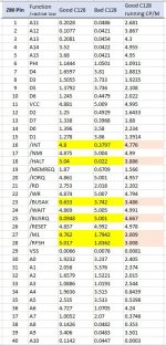

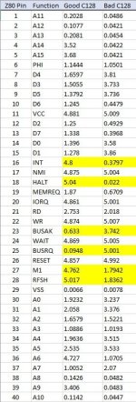

I took voltage readings for every pin on the Z80 on the good and bad C128's. The ones that were significantly different from each other, I highlighted in yellow. Not sure if these indicate a defect with the Z80 or if the cause could be external to the Z80 (e.g. bad trace, bad PLA, bad RAM, etc.). The kernal ROM IC should be fine since I swapped in the one form the bad C128 into the good C128, and it worked fine.

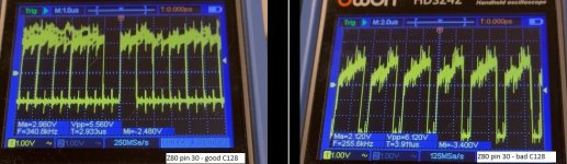

I've also attached a comparison scope reading on pin 30 (A0). The scale is different (Sa/s and horizontal time scale), not sure why that happened. I press my scope's 'Auto' button for each pin reading.

In order for that comparison to work you'd probably need to run the C128 in any mode where the Z80 is active. I.E. either boot CP/M or use any of the odd non-CPM programs that use the Z80.

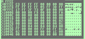

A quick search tells that in C128 mode you put a Z80 program at address $FFEE and then write $B0 to $D505 to switch to Z80. A simple Z80 program that just jumps back to $FFEE and then actually switching to Z80 mode should be possible to do with just a few POKEs. I.E. put $C3 $EE $FF at $FFEE (subject to incorrect byte order error), and then put $B0 at $D505. Would be four POKEs. I haven't got VICE installed on the computer I'm writing this on so can't test it out. I would use the monitor to put in the first three bytes and then use POKE in basic for the last one as it seems like a bad idea to fiddle with the MMU registers using the monitor. Btw a longer example can be found here.
I'd say that INT being low on the bad C128 is a bit suspicious, but I assume that the Z80 runs with interrupts disabled while doing the initialization. Might be worth removing the CIA chip that generates IRQ/INT and see if that signal changes.
It somehow seems like the Z80 is trying to run code but is somehow stuck on the bad C128. BUSRQ and BUSAK shows that the bad C128 has the Z80 active while the good C128 has the Z80 inactive.

Not sure I'm doing this right. In VICE from the C128 40-column screen, I enter 'monitor', then enter 'M FFEE' to display values starting at $FFEE. Per the C128 System Guide, I can simply move my cursor over the values and enter new values and press enter. I do another 'M FFEE' to verify the values saved. I exit the monitor and back at the READY prompt I enter POKE 54533,176. It 'restarts' but just back at the C128 mode 40-col screen...doesn't start in CP/M mode.

re using the monitor: Maybe you have to select a particular bank. Can't remember the details and whatnot. Also you have to be in a mode where I/O is visible at the $Dxxx area but still have RAM at the $Fxxx area I think. If you have all ram, like the standard bank0/1 mode, the write to $Dxxx won't "take" and if you have all ROM you'd probably just jump to Z80 Kernal code or whatnot, maybe, perhaps? Not 100% sure...
Either way sitting at the prompt in CP/M would probably be good enough for taking measurements. Remember that more or less all I/O is done using the 8502. Newer/modified versions of C128 CP/M does console I/O using the Z80.

I've taken voltages of the Z80 with CP/M running (at the A> prompt) on the good C128...see updated chart below.
When the good C128 is in C128 mode or running CP/M, the Z80 HALT and INT lines are always high (inactive), but on the bad C128 they're low. The service manual states HALT is active low indicating the Z80 has executed a HALT instruction and is awaiting some kind of interrupt before execution can continue....while in the HALT state it just executes NOPs. Well, the INT is low as well...driven by "external devices".
Not sure what this means...seems like the Z80 is waiting for instructions that never arrive....or a defective Z80?

HALT ending up somewhere between 5V and 0V indicates to me that it's probably switching between Z80 and 8502 mode. Perhaps CP/M is constantly calling an "is there anything in the input buffer" routine that ends up switching to 8502 mode to call the regular C128 mode Kernal to do that I/O?

Updated the Z80 voltage compare chart with control line notation (used a forward slash since an underscore may be misread as an overscore for the letters below). Also attached the scope readings of pins 16 (INT) and 18 (HALT) on the good C128 running CP/M (80-col mode) and bad C128. The HALT line (pin 18) on the good C128 looks to be pulsing (1.023 MHz) but looks consistently low on the bad C128.
It's the 'Auto' button that's the problem. If a signal is changing between low and high during the reading, it will set a vertical scale that will clearly show the ~0V level and 3-5 V level (whatever high is for that particular signal). If it's consistently low, it will set a vertical scale that will clearly show you the noise around 0 V (perhaps, giving a clear waveform ranging from -0.2 to +0.2 V), which is just hard to read because the noise isn't important. Similar issues arise with the horizontal scale.
When doing these measurements, I'd suggest you not use auto mode, but instead always set your vertical scale to, say, 2 V/division, so that both you and we will find it easier to see at a glance what the signal level is, without having to look at the scale setting and/or the measurements to figure out if we're looking at an actually changing value or just noise.
For the horizontal setting, I would start with 10 μs/division (or maybe even higher); this will easily show you signals changing once every few dozen clock cycles, and you can decrease that ("zoom in") if it's changing quite quickly and you need to see more detail about when it's changing. Whatever you use for horizontal scale, use the same for both the working and the broken C64.

Again, INT (pin 16) is always low (active) on the bad C128 so not sure what would be causing that...I'll have to look at the schematic to see where it leads.
Also, for RD (pin 21) they both oscillate but the bad C128 max volage is 3.66V but the good C128 gets to 4.4V. Not sure if that's an issue.

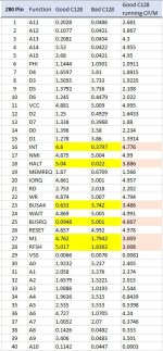

I've updated the table to show each pin's reading with 2V/division (vertical) and 10 μs/division (horizontal). The differences are highlighted in yellow.
That's a great table, and gives some good clues. In particular:
/INT always asserted is almost certain to keep things from working, so that's a good thing to track down.
That is in theory ok, since a TTL "on" level is anything over 2.8 V, and it's quite normal in TTL systems for "on" signals to be under 4 V all over the place. But it is slightly worrisome that in two systems that are supposed to be identical the same signal is at different levels. But maybe not too worrisome, since TTL "on" outputs can often vary a bit in voltage depending on other loads on the chip. On a MOS 6502, for example, you'll see the "on" levels for address lines vary a bit depending on how many address lines are "on."
