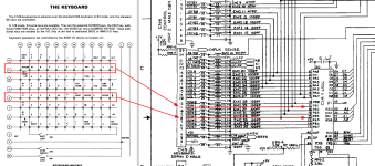

Hi guys,
I just purchased a C128D for my collection, but the keyboard doesn't completely work. I wasn't too worried as this is a common issue where keys like W, R, Y, I, P etc are not working. I was able to identify there is a problem with rows 11 and 8 in the keyboard matrix. So either cold solder joint, bad cable, bad connector or a bad CIA.

- Next I tested the keyboard using some stainless steel tweezers to active the keys. And the ones that worked when the keyboard was assembled worked as expected, but not the ones that where broken (W, R, Y, enter, ... the ones from rows 11 and 8 in the matrix)
So I expected a broken CIA. Fortunately the C182D has 2 identical CIA's (U1 and U4) so I swapped them to see if this would solve the keyboard issue. But it didn't... with the CIA's swapped the same keys in rows 11 and 8 are still not working which is where I'm puzzled. I also measured a non working key (W) to the cable solder joints, and also that was fine.
The mainboard I have is a revision 7:
I'm a bit lost here now.. what else could cause 2 rows in the keyboard matrix to fail? Am I correct the overview below is all there is to a keyboard connected to a C128?
With kind regards
Yes, that's pretty much it. The C128D/DCR's detached keyboard is set up to look like the regular flat 128 keyboard to the computer. If swapping the CIAs didn't change anything, then the problem is downstream of the CIA. There's not much else to go wrong, so most likely it's indeed a fault in the keyboard somewhere.

8x8 of the 8x11 matrix is the same as on a C64 or VIC 20, and the pinout of the DB25 for this part (and RESTORE) is the same as on a SX64.
5x5 of the 8x8 matrix of a C64 or 8x11 of a C128 is connected to the directions and button on the joystick ports. Thus the problematic ROW1 and ROW4 in your case should be connected to joystick port 1.

Ok, I found the problem. I added some ESD protection to the joystick ports, small PCB with 2 SRV05-4 and 2 caps. But on 1 of the PCB's, the SRV05-4 was mounted 180degrees turned causing 1 of the CIA input pins to be pulled low. I removed the protection and keyboard works.
@MiaM - thanks for the tip about the joystick ports. That got me thinking :-).
