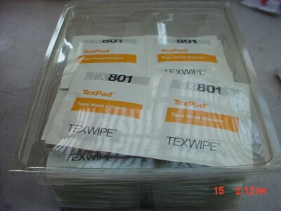

Speaking of Texwipe, back when I had a student job as a computer operator at UCI back around 1990, we used Texwipe brand wipes for cleaning heads on the magtape drives. I seem to recall that they were a woven cloth, but I might misremember that. I don't remember whether they were pre-moistened or not. I don't remember which specific Texwipe product we used. If anybody remember which Texwipe products were commonly used for purposes like that back then, my memory would appreciate a nudge.

When I was a student operator at Rose from 1979-1982 we used TEXPADS then, also on our TU78's and TU77's. I chuckled when I saw the pictures on that listing. Memories...
I think they were a thicker woven paper/fiber rather than cloth. At least the ones we had were. They came pre-moistened in the packets.
I wonder if TEXPADS are what I used a decade later? I wish my memory was better.
Edit: The photo doesn't trigger my memory, but I wonder if this is what I used back around 1990? It doesn't seem to be a current product any more, and the TX801 part number appears to have been recycled for a cleanroom swab now.
