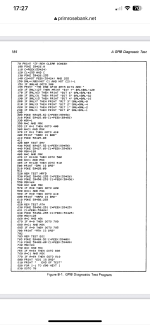

So, find the book I recommend (search for Primrose PET and the IEEE488 interface) and enter the BASIC test program (page 188?) to find out which parts of the IEEE488 interface is faulty.
Is this the one. Unfortunately two of my keys aren’t working so I can’t type it in.
