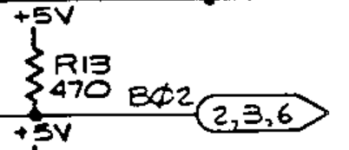

It says it comes from sheet -06.
It does, and it doesn't! If you chase this signal back to sheet 6, it comes (ultimately) from sheet -01 - so that is where we need to go to.
Check the 6502 CPU pin 39. The 1 MHz clock should be present here.
This signal is then buffered by UD15. The clock signal goes 'in' on pin 1 and comes 'out' from pin 2. Check both these pins for our 1 MHz clock.
If it is present on UD15 pin 2, there must either be a break in the PCB track or something is dragging the signal HIGH or LOW.
You can 'chase' the signal from sheet -01 to sheets -02, -03 and -06. Look for the signal on these sheets (IC pins) and see if the 1 MHz clock is present or not.
Note that resistor R13 must be present and working. The resistor pulls up the signal to +5V, and UD15 pulls it down to 0V (when required).

Is the sheet number the last digit of the file name?
ok... 6520s pin 23 also says b02 and there is some signal there at 160khz... i have no clue how to trace this bloody signal
EDIT: Don't necessarily trust the Commodore schematics (especially the scrawled pin numbers). Download the 6520 and 6522 datasheets and check the pin numbers. For both devices, the clock pin is 25 (as I detail below). Hence why looking at pin 23 you don't see 1 MHz - it is not the correct pin!

So, follow the pin and PCB track back from UC3 pin 3 looking for signs of PCB damage.
Unless we are chasing another Commodore schematic error...
The Univ2 has UC3 pin 3 pulled high and an additional gate before UC3. Your PCB is definitely marked 8032080 isn't it?

That pin is connected directly to +5V!
Are you doubly-sure this board is a 8032080?
It is a good thing we did NOT just bridge these two points!
I have no idea :) that is why I posted the picture in the beginning. Also in the last picture you can see the numbers 8032080 on the right. Please tell me what this monster is. but if assy 8032080 is not a 8032080 then the documentation is an issue...
Good news if you can not figure out what this is, what chances do I have. Null...
A univ board (universal) is an 8032080.
A univ2 (universal 2) is an 8032090.
Very close together, but the logic is different around UC3.
