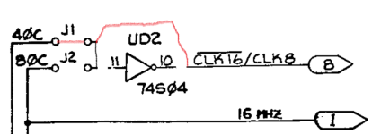

We could update the schematic for others, but what 'is' correct for this machine should be as identified here: https://www.zimmers.net/anonftp/pub/cbm/schematics/computers/pet/univ/8032080-1.gif, but it clearly isn't for your machine. So, what is right?
There is still something not correct with your PCB - but I know you don't care anymore...
This is the modification you now have (excuse the poor markup):
J1 should be installed and J2 not installed (according to your photograph).
This means that the 8 MHz clock (connected to point 40C) should be present on J1. J1 should link the 8 MHz clock to the other side of the J1 link, which should be connected to the CLK16/CLK8 signal.
This is irrespective of whether the solder blob (bridging over UD2/10 and UD2/11) is present or not.

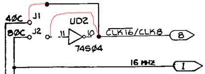

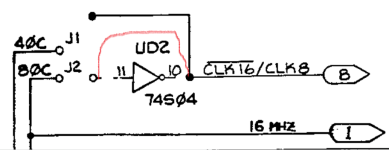

Ah, I think I have found it by looking at your photographs and tracing out the PCB tracking. This is what I think the circuit looks like:
40C is the 8 MHz clock and 80C is the 16 MHz clock.
The J1 link is installed (i.e. that machine is 40 columns) shown in red above.
The 'other' end of J1 and J2 is commoned by a PCB track (I have shown this in black).
The common part of the J1/J2 link (I am guessing here) is connected to UD2 pin 11. Don't forget that that the modification cut pins 10 and 11 of UD2 (thus isolating the gate from the circuit) and the 'solder blob' bridged the PCB tracks connected to UD2 pins 10 and 11 (as I have shown above in red).
The 'original' circuitry (with the UD2 gate in circuit) outputted /(CLK16/CLK8) (notice the subtle placing of the NOT '/' symbol and the parentheses).
The modified circuitry removed the UD2 gate and the circuit now outputs CLK16/CLK8 (a non-inverted clock signal from what it was previously).
The original schematic appears to have been incorrect anyhow - and, therefore, the factory modification and solder blob did not make sense. The above does, however, now make sense to me - and accounts for why the solder blob IS important...
Issue closed (to me at least) :)!
