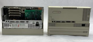

I managed to pick up three of these awesome computers in hopes to make one 100% version. Looks like I have my work cut out for me! I’ve never recapped a PSU, but all three are shot. I’m sending out two of them to a wonderful human that is going to recap them for me. I’d like to try and tackle the third so I can learn.
After that I hope it’s pretty straightforward. I know some people managed to get an AMD 586 as a drop in upgrade. Also I’ve heard the CF card is hard to get working in this. I hope that’s not the case since all three are missing hard drives. I also think I need a CD drive, but looks like it needs to be external.
Please let me know your thoughts on this and what I should consider!

If you do manage to find one, don't be dumb and try and immediately power it on. The PSUs in those things are a dangerous mess.
I worked on two for another member here earlier this year and they were electrolyte bombed to hell. Managed to get one of them working again, the other had I believe a blown up power IC that is near unobtanium. There's a design fault where said IC is fractions of an inch from rectified mains, and the leaked electrolyte can result in a bridge forming from +370v to a low voltage trace and things just get worse from there.
Due to the narrow nature of the PSU, Compaq had to compromise on safety to have such a low profile design.

Oh, recapping the PSU will be an absolute nightmare. Be prepared for 4-8 hour sessions over multiple days. You'll need to remove the daughterboards and mosfets and clean the entire board within an inch of its life with solvents, soap and water to get rid of the electrolyte. You'll also need to remove the transformers and clean them, because electrolyte will wick up their legs and start eating the copper windings. There's also a large copper shunt that needs to be cleaned.
You'll probably have to end up replacing diodes, ceramic caps, resistors and other parts due to the nature of the electrolyte. It can wick inside those components and corrode them from the inside out. Don't just clean and recap, you'll need to test every single component on the board. This is important, because if electrolyte is shorting something internally, or creating phantom bridges, it can blow up and take all of the money and work with it. And don't forget to replace the power switch. If the spades on the back of the switch are discolored, like blue, the switch is damaged and needs to be replaced. I would do it anyway because the contacts can arc and carbonize and cause enough of a voltage drop to cause problems.
I have a partial parts list of components on the power supply somewhere. If I can find it, I can post it if you need it.
My Portable 486 was working but started flaking out and smelling like fish after it ran for two full days at a retro fair. Contrary to GiGaBiTe's experience, fixing that only required replacing the caps and cleaning up under a few of them, as the electrolyte leakage was small and only happened for those tiny caps at the bottom of the PSU which are encased in heatshrink. In case you might find it useful, my notes (for a 220V PSU in case they are not multivoltage, don't remember) are in this Google Sheet: https://docs.google.com/spreadsheets/d/1dDGA_tNauIGRGyKVHcXrOHezk4TOOm9lcnAxqPL2UvQ/edit?usp=sharing
Note that I didn't change the two large ones, as replacements were expensive and they looked and measured perfectly fine.
