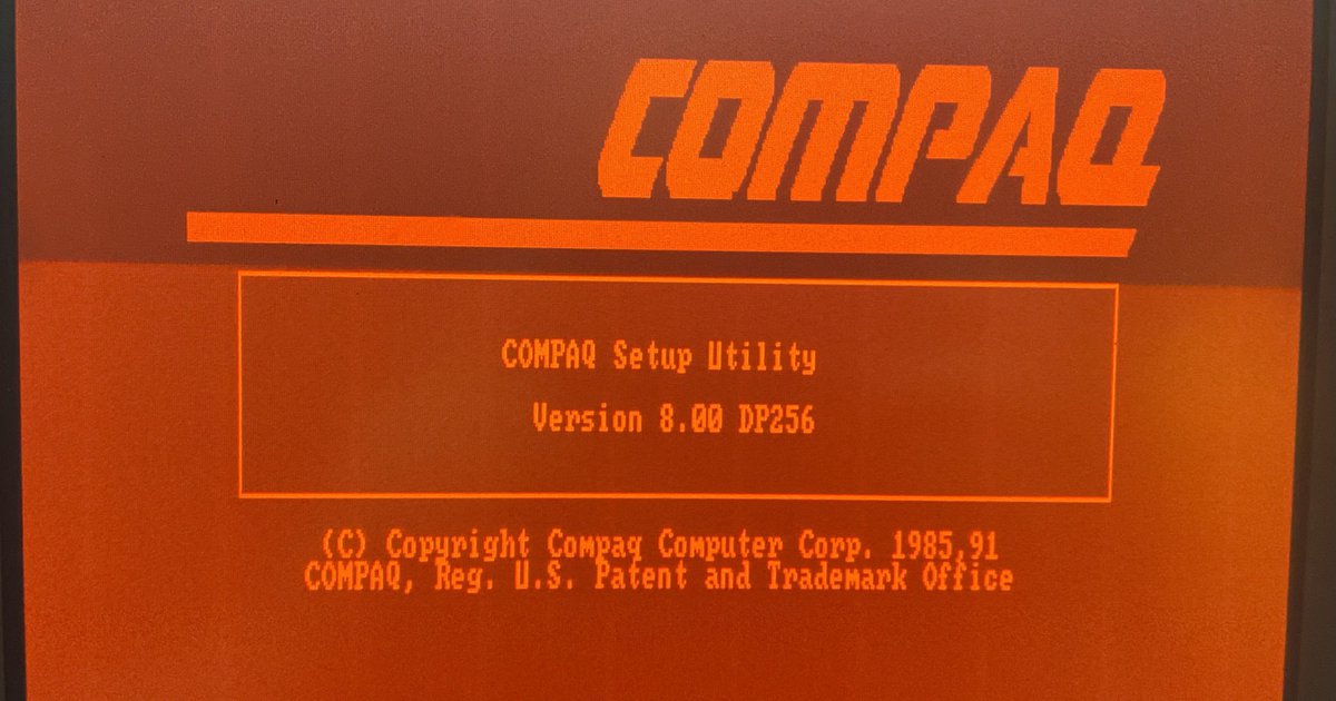

Really! There's no BIOS or setup screen. You have to use the diagnostic disk to enter in the settings.
What you mean is that you need a setup program on disk to set the BIOS options. Every PC & compatible has a BIOS AFAIK; without a BIOS, how would the computer be able to read the setup disk in the first place?
Yeah, that's what I meant to say. I was trying to say, "There's no way to configure the internal BIOS without the use of a seperate configuration program, such as it's own Diagnostic Disk." Or, there is the option of using GSETUP.

Found a site that has the diagnostic diskette listed: https://forum.winworldpc.com/discussion/8321/compaq-portable-286-diagnostics-diskette
Note: these might be images of the diskette, hard to tell.
360KB 5.25" Floppy: ftp://ftp.hp.com/pub/softpaq/sp0000-0500/sp0316.zip
720KB 3.5" Floppy: ftp://ftp.hp.com/pub/softpaq/sp0000-0500/sp0308.zip
GSETUP would also suffice: http://www.minuszerodegrees.net/5170/setup/5170_gsetup.htm
Yes - those are the correct disks. I used those files recently to make disks for my portable.
