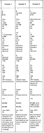

A July 1973 Datapro survey notes the machines available from Comstar at the time. Besides hardware specifications, it also notably documents the numbers of units installed and date of first installation. For the Star System 4, apparently 300 units had been sold by 07/73, and remarkably, the first delivery was in February 1972!! This puts the System 4 ahead of even Intel's own 4004 prototyping boards as the first microcomputer. The first 4004 board kits were first announced in March 1972 and began deliveries in November.
(Source: All About Minicomputers, July 1973. Online @ bitsavers here: https://bitsavers.org/pdf/datapro/d...x/70C-010-20_7307_All_About_Minicomputers.pdf)
