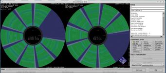

I created raw SCP images and then converted them to IMG using HxC. I ran one of them through ImageDisk which identified them as MFM 40 track, 8 sector, double-sided 512 byte disks. I'll put the raw SCP images on my GitHub shortly. I don't think I have some of the diskdefs you are showing above so I'll add them.
Rich
Ok, I spent a bit of time with this over the weekend, and with the help of both Peter Higgins and ClaudeAI, we discovered that the extent map was trashed -- somehow overwritten by a pattern that doesn't match any CPM setup. But, Peter recovered 12 files. Claude also extracted the same 12, identified which others were missing, and then provided the raw sector data. Even so, asm86.cmd still seem damaged, and ddt86.cmd, systat.cmd and systat1.cmd (not sure why Lomas had two versions) are missing. Manual reconstruction based on sector data would be needed. Grrr.
If anyone has working copies of these, please PM me. I'd rather not try to manually assemble these if I can avoid it. Thanks!
Another list member (@newcastle_j) and I have been noodling over this for about a week now and here's what's happening.
With cpmtools I can see the directories on all of the disks (other than disk 1 which is trashed) but when I extract or inject files from/to an image, the files are corrupted. The files appear in the directory, but are mangled or truncated. We've used the Eagle CP/M-86 emulator on PCJS (which is a CP/M 2.2 emulation) to read the Lomas disks and the files appear complete -- if you type an assembly source file, it's complete with no corruption. I'm using the "ibmpc-514ds" definition. I used PCJS to create a new 320k blank disk and copy the files from the Lomas disk to the new disk and they copied fine -- not corrupted. But if I manipulate
So, there has to be an issue with the disk definition. Here's the definition I'm using:

After looking at this https://www.seasip.info/Cpm/cpm86form.html, I think the issue is that cpmtools may not deal properly with CP/M-86 2.x disk formats. More research to be done...
I don't know if it matters, but:
https://www.seasip.info/Cpm/format22.html
https://www.seasip.info/Cpm/format31.html
According to the second page, CP/M 3.1 actually defines a usage for S1 (directory entry) as Last Record Byte Count. Of course it may not be used that way in reality.
It also adds a couple fields to the DPB:
DEFB    psh    ;Physical sector shift, 0 => 128-byte sectors
            ;1 => 256-byte sectors  2 => 512-byte sectors...
DEFB    phm    ;Physical sector mask,  0 => 128-byte sectors
            ;1 => 256-byte sectors, 3 => 512-byte sectors...
Incorrectly breaking up larger sectors into 128-byte pieces might explain file mangling.

Here is what it repaired/Fixed:
$ python3 cpm_repair.py
Scanning CP/M directory entries...
Fixing 3:``. entry 0: Extent changed from 0 to 0
Fixing 3:. entry 1: Extent changed from 0 to 0
@. entry 3: Extent changed from 0 to 0
Fixing 18:$T. entry 4: Extent changed from 255 to 0
Fixing 0:. entry 5: Extent changed from 0 to 0
Fixing 8:. entry 6: Extent changed from 4 to 0
Fixing 8:. entry 6: Capping invalid RC (133) to 128
Fixing 14:. entry 7: Extent changed from 20 to 0
Fixing 14:. entry 7: Capping invalid RC (133) to 128
Fixing 29:.! entry 8: Extent changed from 1 to 0
Fixing 4:.@ entry 9: Extent changed from 65 to 0
Fixing 4:.@ entry 9: Capping invalid RC (135) to 128
Fixing 75:LM. entry 10: Extent changed from 36 to 0
Fixing 75:LM. entry 10: Capping invalid RC (133) to 128
Fixing 0:␦ntry 11: Extent changed from 1 to 0
Fixing 5. entry 12: Extent changed from 11 to 0
. entry 13: Extent changed from 17 to 0
. entry 13: Capping invalid RC (132) to 128
Fixing 3:MXLoad. entry 14: Extent changed from 1 to 0
Fixing 0:SYSTAT.D entry 18: Extent changed from 1 to 0
Fixing 0:ASM86.D entry 19: Extent changed from 1 to 0
Fixing 0:SYSTAT1.D entry 25: Extent changed from 1 to 0
Repair complete. Fixed 22 anomalies. Saved to CPMFIX_D1.RAW
larry@larry-HP-EliteBook-8470p:~/IMDs/Lomas-Thunder$ hexedit CPMFIX_D1.RAW
[1]+  Stopped                 hexedit CPMFIX_D1.RAW
Hopefully, it will be repaired properly.
Larry
  • CPMFIX_D1.zip
    CPMFIX_D1.zip
