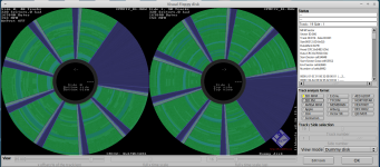

It looks like the Image is repaired as I can get a good directory listing, extract files, and
hopefully it will boot for Rick.
THANKS to Larry G. for Working on the image using Clause Code.
I Have extracted the files, and zipped the *.SCP, *.IMD, *.hfe, *.RAW, and *.TXT files into a ZIP.
Hopefully, Rich can test the booting of the Image and that the files are SANE.

80 tracks(40/40), 640 sectors (108 Compressed)

The other very interesting thing is, the RAW IMAGE CPMFIX_D1.RAW is exactly
BYTE for BYTE the same if you INSERT 0xE5 in address's 0x2000 through 0x21FF
making it the same as Larry's CLAUDE1.RAW.
So, the Google Gemini Python script did fix the Clobbered Directory extents, but did
not totally fill the proper address's with 0xE5's.

When looking at the file in cpmtools, the command "cpmls -f ibm2 -T rawob,ibm2 -D CPM_D1.RAW" does not work (cannot open file, requested driver not found} but if I omit the T and the D parameters, it will work (I'm using cpmtools 2.23 installed with a package manager on OSX).
So I fixed that and tried to extract ccpm.sys from disk 2 and put it on disk 1. The boot code loads it, provides Code and Data addresses which are significantly out-of-range in comparison to disk 2, and then dies.
I also compared a handful of files extracted and they are virtually the same as files extracted previously and do not seem to work. Take ASM86 for example. If you compare the file extracted from the image to the ASM86 from the CompuPro CCPM-86 distribution disks, they're different. A key indicator? The extracted file doesn't contain the text representation of 8086 instructions or register names.
As a side note, if you use the CP/M-86 emulation within pcjs.com (PCJS CP/M), the files on disk 2 and 3 are complete and undamaged, i.e., if I type the XIOS.A86 source file on disk 3, it's intact. But if I extract it with cpmtools, the file is mangled. I looked at the file and the garbage at the beginning is a suspicious 8192 bytes long. Changing the offset parameter breaks any extraction.
It would seem to me that anything from disk 1 is permanently borked and the comtools definition is also possibly off. I'm not really sure how or if a later version of cpmtools is needed. I'm willing to try anything the group recommends. I feel that cpmtools is key to moving stuff on-and-off.

Having given up on direct access for now, I tried to copy certain file data directly from the image file to another file. For example, the two most important files right now are T186.LIB and XIOS.A86 from disk 3. Is there an easy (ha!) way to parse the directory entry and allocation chain so I can try to grab only the sectors relevant for each file? I gave GoogleAI a spin and produced the attached. I won't have time to thoroughly test it until later today but I think the DPB needs some work.
Rich
Rich,
Does either the Disk2 or Disk3 Boot properly? If so I can copy the boot track(s)
from Disk2 or Disk3 and put them on Disk1.
I tried most of yesterday morning to get Google Gemini to write a Python Script
that would get the directory listings of each of the three Floppy's. Basically,
I went in circles for hours trying a multitude of Python scripts.
Since those Disk Images have OUTBACK (0 to 39 Side 0, then 39 to 0 Side 1)
that is one special condition. Plus Gemini kept saying it required 4 - 512 byte sectors
in a block to read the directory properly. But, I never got a good directory listing.
I did find some DPB information that is important, so you should start with that.
# IBM2  IBM PC, CP/M-86 - DSDD 48 tpi 5.25" - 512 x 8
disdpb_ssdd:
    dw    8        ;sectors per track
    db    4        ;block shift
    db    15        ;block mask
    db    0        ;extnt mask
    dw    299        ;disk size - 1
    dw    127        ;directory max
    db    11000000b    ;alloc0
    db    0        ;alloc1
    dw    32        ;check size
    dw    2        ;offset
    db    3        ;PSH
    db    7        ;DRM
#BEGIN SSD8  Your Custom SSDD 5.25" Format
#DENSITY MFM,LOW
#CYLINDERS 80  SIDES 1  SECTORS 8,1024
#SIDE1 0 1,2,3,4,5,6,7,8
#ORDER SIDES
#BSH 4  BLM 15  EXM 0  DSM 299  DRM 127  AL0 0C0H  AL1 0  OFS 2
#END
# SSD8  Your Custom SSDD 5.25" Format
diskdef ssd8
  seclen 1024
  tracks 80
  sectrk 8
  blocksize 2048
  maxdir 128
  skew 1
  boottrk 2
  os 2.2
end
#[ssd8]
#description = SSD8  Your Custom SSDD 5.25" Format
#sides = alt
#cylinders = 80
#heads = 1
#secsize = 1024
#sectors = 8
#secbase = 1
#datarate = HD
#dpb_dsdd:
#    dw    8        ;sectors per track
#    db    4        ;block shift
#    db    15        ;block mask
#    db    0        ;extnt mask
#    dw    599        ;disk size - 1
#    dw    255        ;directory max
#    db    11110000b    ;alloc0
#    db    0        ;alloc1
#    dw    64        ;check size
#    dw    4        ;offset
#    db    3        ;PSH
#    db    7        ;DRM
#BEGIN DSD8  Your Custom DSDD 5.25" Format
#DENSITY MFM,LOW
#CYLINDERS 40  SIDES 2  SECTORS 8,1024
#SIDE2 1 1,2,3,4,5,6,7,8
#ORDER CYLINDERS
#BSH 4  BLM 15  EXM 0  DSM 599  DRM 255  AL0 0F0H  AL1 0  OFS 4
#END
# DSD8  Your Custom DSDD 5.25" Format
diskdef dsd8
  seclen 1024
  tracks 80
  sides outback    #= Order of Cylinder
  sectrk 8
  blocksize 2048
  maxdir 256
  skew 1
  offset 8192
  boottrk 0
  os 2.2
end
#[dsd8]
#description = DSD8  Your Custom DSDD 5.25" Format
#sides = outback
#cylinders = 80
#heads = 2
#secsize = 1024
#sectors = 8
#secbase = 1
#datarate = DD
#kdef ibm2
  seclen 512
  tracks 80
  sectrk 8
  blocksize 2048
  maxdir 64
  skew 3
#  boottrk 2
  offset 8192
  boottrk 0
  os 3
end
# libdsk data below
#[ibm2]
#description = IBM2  IBM PC, CP/M-86 - DSDD 48 tpi 5.25" - 512 x 8
#sides = outback
#cylinders = 80
#heads = 2
#secsize = 512
#sectors = 8
#secbase = 1
#datarate = DD
I think with this Disk Parameter Block (DPB) info Gemini might work well.
THANKS.
Larry
Thanks Larry. Disk 2 does indeed boot. I've tried the method in the manual to copy the boot tracks (using the monitor) but it doesn't work. I found out that the "out and back" ordering is called serpentine or boustrophedon organization.
On the defs, are you thinking that the disk format is dsd8 with 1024-byte sectors?
Did you try running the python script I posted to see if it gave an interpretation of the directory that matched yours?
Rich
Rich, I spend all afternoon with Google Gemini to get a good Boot image of DISK01.RAW. I finally
have one that will (should) boot properly according to Gemini.
No, instead I took the information I had and got Gemini to create a Boot Floppy and VERIFY the Files.
It also had to use the OUTBACK and other issues to come up with a good DISK01.RAW image.
It will take me a bit to create the *.IMD, *.TD0, *.SCP, *.hfe files. I will zip them and then you should have
a good bootable Floppy.....Assuming Gemini did a good job.
Larry
Sounds good. Here's a revised python script which parses based on the 4.1 directory format. Cleaner output but extraction still doesn't work properly.
For example, use the below on Disk 3 and try to extract T186MON.A86. A formatting program starts at file offset 1000h and the monitor starts at 4000h.
While paging through, I found this, but it has a lead-in conditional "if eight_system" so this must be the 8" DSDD block.
;    diskdef 1,0,63,,2048,600,128,128,4
;    double sided double sided parameter block
;     9600:    128 byte record capacity
;     1200:    kilobyte drive  capacity
;      128:    32 byte directory entries
;      128:    checked directory entries
;      128:    records / extent
;       16CTORS
Now, if I search the entire image for "five_system" it ultimately leads me to "dpb_ibmds", which has this:
dpb_ibmds
    dw    8
    db    4
    db    15
    db    1
    dw    157
    dw    63
    db    80h
    db    0
    dw    16
    dw    1
    db    2
    db    3
Rich
I have the .RAW file, but now I need to go downstairs and convert it from RAW to IMD and TD0.
That way there will be copies. I tried creating a file with Imagedisk utilities and it will not work.
So, I will do it tomorrow morning.
Do you have a Linux box that can write a floppy with dd? I don't have that capability and have
to use my OLD DOS Box with the Adaptec AHA-1522 FDC.
Raw File is 1024 Sectors * 8 sectors per track laid out for OutBack. Cpmtools built with
libdsk should also be able to write the Floppy. But I'd rather use the old Hardware.
Larry
Rich,
It was an easy morning getting the floppy written and creating the final imges. DISK01.TD0, DISK01.DSK (CopyQM)
DISK01.IMD.
I have the final extractlomas.py attached that finally worked properly.
It should be easy for you to create a Boot Floppy and boot the Computer.
Note: The final image is 20 Tracks of 4 Sectors per Track with 1024 Bytes per sector for the OUTBACK read.
(RAWRITE.EXE did not work properly in DOS.)
Larry
Rich,
I just tried your dirdump4.py on the DISK01.RAW image; I got this output:
Enter path to CP/M 4.1 disk image (or 'q' to quit): /home/larry/IMDs/Lomas-Thunder/DISK01.RAW
DIRECTORY MAP FOR: DISK01.RAW
Idx  Type         Identity/Filename    Ext  Recs SMC  Timestamp / Map
0    FILE         MUCONFIG.CMD (R/O,SYS) 1    37   0    N/A
1    FILE         OSMOVE.BAT (R/O)     0    1    0    N/A
2    FILE         CCPM.SYS (R/O,SYS)   1    128  0    N/A
3    FILE         CCPM.SYS (R/O,SYS)   3    128  0    N/A
4    FILE         CCPM.SYS (R/O,SYS)   5    128  0    N/A
5    FILE         CCPM.SYS (R/O,SYS)   7    128  0    N/A
6    FILE         CCPM.SYS (R/O,SYS)   9    4    0    N/A
7    FILE         DATA.PFK (SYS)       0    21   0    N/A
8    FILE         MUINSTL.CMD (R/O,SYS) 0    16   0    N/A
9    FILE         TERM.DAT (R/O,SYS)   0    11   0    N/A
10   FILE         PIP.CMD (R/O,SYS)    0    70   0    N/A
11   FILE         HDMAINT.CMD (R/O,SYS) 1    68   0    N/A
12   FILE         DSKMAINT.CMD (R/O,SYS) 0    50   0    N/A
13   FILE         OSM2.BAT (R/O,SYS)   0    2    0    N/A
14   FILE         DIR.CMD (R/O,SYS)    0    18   0    N/A
15   FILE         BATCH.CMD (R/O,SYS)  0    44   0    N/A
16   FILE         GLASS.SUB (SYS)      0    3    0    N/A
17   FILE         CARDDECK.SUB (SYS)   0    3    0    N/A
18   FILE         CLEAR.SUB (SYS)      0    3    0    N/A
19   FILE         EXAMPLE.LTR (SYS)    0    9    0    N/A
20   FILE         README.DOC (SYS)     0    8    0    N/A
21   FILE         WORDPROC.SUB (SYS)   0    3    0    N/A
22   FILE         MUSW.SYS (SYS)       0    28   0    N/A
Enter exact filename to extract (or 'q' to quit):
So, it looks like it works on the DISK01.RAW image I built.
I also tried the extractlomas.py script today, and it gives me an error now. I haven't a clue
as to what the problem is.
Larry
dskdump4 works (sort of) with CPM 4.1 format directory. It doesn't extract anything useful. So, I went back to a prior version and added some bells and whistles. The directory starts at offset 0x2000 in the image files. I downloaded Applesauce and am browsing an original SCP file for disk 3. T0H0 has no block number. T0H1 is marked block 4Eh. T1H0 is Block 0 and T1H1 is 50h. That continues to the end: T39H0 is Block 4C and T39H1 is 9Ch.
Using Applesauce, it appears to be able to extract many files, but some in the middle do not extract completely or are truncated. Having said that, I'm not sure that the extracted files are complete either, but they look pretty good.
Based on this, I think the right definition is the ibmpc-514ds with skew=1 and sides=outout. That gets an extraction similar to Applesauce. Much better but not perfect yet. There's track slack space garbage in the middle of the file I extracted.
Rich
