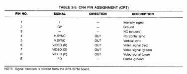

I know this have been duscussed before but i didnt want to reopen an old thread... so here is my issue..
Following the documentation I found on the qx-16 tech documents and the qx-10 tech document I made a cable to connect the qx-16 video port to the qx-10 monitor.
I'm mapping the pins as follow
QX-16 ------> Q701A monitor.
7 ------- > 1
4 -------- > 3
5 -------- > 2
2 -------- > 7
2 -------- > 5
All dip switches on the QX-16 are ON ...
When I turn the QX-16 on, the Monitor comes UP (i made a cable to provide 12V to the monitor) but I don't see anything on the display... If I crank up the monitor's brightness knob I can see the raster but cant see any text...
I did check with the scope and I see the horiz and vert pulses fed to the monitor and also i see activity on the monitor's video input...
Any advice for any additional troubleshooting? Is there any way I can test the monitor to discard is broken? I actually believe the qx16 is booting but i cant see if it actually did....
Im looking forward to your replies...
Thanks in advance!

I finally got the monitor to work, and the issue was actually the cable I made. I was following a diagram I found here in the forum that say you should use the green output pin for the video but that is actually incorrect, you should use the intensity pin (pin 1) as video output.
in summary this is the correct wiring to connect a qx-16 to a Q702A (QX-10) monitor
QX16 ----------------- QX10
PIN 1 -------> PIN 1
PIN 2 -------> PIN 7
PIN 4 -------> PIN 3
PIN 5 -------> PIN 2
