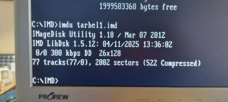

Hi Larry,
I have an S100 8800B with UART at 10H, and a Tarbell 2022 DD FDC, with dual Shugart SA800 single-sided drives.
All hardware appears to work, and drive A seeks home and loads head trying to boot. So I need CPM boot media - 8" 77x26x128 single sided. - normal stuff.
I have a working Imagedisk system with an 8" drive so if I could get a CPM 2.2 .IMD image file with a BIOS that matches this SIO and FDC I could boot. Want SSSD, don't care about double density.
And the TARBELLDD-SSDD.DSK is an 8" Boot Floppy that should work to Boot?
I wonder how they originally created the .DSK image? I tried TRSTools and it
doesn't like .DSK types.
I used libdsk's dskconv to do the conversion with format A1 SS/SD.
$ dskconv -format a1 -otype imd TARBELLDD-CPM22-SSSD-48K.DSK TARBELLDD-CPM22-SSSD-48K.IMD

Thanks so much Larry, I can create a disk with that file but it doesn't boot.
The imagedisk display says 300Khz DD, so I think we're real close but data rate isn't right for 8" floppy.
Please try again for me.
Here's what IMDU says for that image you made: 300KHZ DD 26x128.
It should be 500KHZ.
Make sure to use the SSSD .DSK file because I want single density.
Very close.

Ragnarock,
There is no provision for selecting 300 or 500 KHZ when using DSKCONV or DSKTRANS.
But, IMDU has the capability of changing the Rate to 500kbps by selecting the T3=500 Rate and
reprocessing the Image. I used DOSBOX to execute this command.
IMDU  TARBEL~2.IMD TARBEL1.IMD T3=500
That shows as 0/0 500kbps DD 26x128
So, this file should boot. I hope it does.
Larry

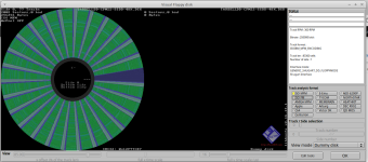

If the previous file does not work delete it, then try these as I used HxC to import the file, and exported
as IMD files. One SS/SD and one SS/DD. They should work fine.

Sorry it didn't work, I don't know why. I tried IMDU with T3=500 and T3=250 and neither worked.
When writing it says everything right but it still says DD and it should say SD, regardless of the speed I set.
IMDU should report 250KBPS (Bytes) which is 500KHZ but it reports 500KBPS which is double density.
I need 250KBPS which is single density, but still 500KHZ
I'm thinking that those .DSK Images are really .RAW files. So that is what I did with HxC software was
to load the SS/SD & SS/DD as .RAW files then exported them as IMD files. HxC should have
made the correct conversions.
Did the Tarbell-HxC-Conversions work properly?

And one of those 2 files you sent is double sided (154 tracks), should be single sided 77.

I've tried all your files, and various conversions with IMDU but none booting.
What I need is the SSSD-48K file converted to 250KBPS (500KHZ) 77x26x128 single sided.
Thanks for your help. There are some other unknowns including my hardware but it's doing everything it should and I've tested my uart manually for 2SIO config.
OK, I reworked those both and I want you to look at those again.
Everything appears correct. I only get one side on both files.

The SSSD file shows up in IMD as 300K DD, single sided 77x26x128 -- it writes but does not boot.
The SSDD file shows up in IMD as 500K DD, DOUBLE sided 77x26x128 -- it writes but does not boot.
What I THINK I need is that SSSD file made as 250KBPS which is (500khz) single sided. But doing that conversion in IMDU with T3=250 doesnt work
Here are Screen shots of the settings. They look correct on the PNG files for SS/SD.
I think I know what the problem is. I was using MFM vs FM so I reworked it again.
See if this boots.
