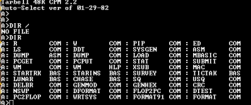

Larry, that one booted! and it formatted on imagedisk as 500k single density with having to mess with any settings so I think it's a winner.
Tarbell 48K CPM 2.2 auto-select ver of 01-29-82
on my Altair 8800B with Tarbell 2022 double density FDC, and serial ports modified to run at 10H, dual SA800 drives.
I suspect some of your other attempts also worked along with changes in settings I tried because there appears to be some intermittenancy with my hardware which I haven't figured out yet.
Thanks so much for your help and to the others who have helped including my TN friend.
-- Roger Arrick -- Tyler, Texas --

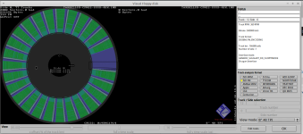

GREAT NEWS. Now, I am going to go back and get PNG's of the settings and
create a step by step of how to make one that works for SS/SD & SS/DD,
so anyone who comes across this later will have good information to follow.
I think the HxC software was resetting to it's best guess of 300kbps and 300 RPM,
but that wasn't correct. I should have loaded each *.IMD I created and double checked
vs assuming it was 250kbps & 360 RPM.
Larry

So, here are step by step directions for creating Images that boot for SS/SD & SS/DD for the
Tarbell FDC.
Roger's Information about his computer:
I have an S100 8800B with UART at 10H, and a Tarbell 2022 DD FDC, with dual Shugart SA800 single-sided drives.
All hardware appears to work, and drive A seeks home and loads head trying to boot. So I need CPM boot media
- 8" 77x26x128 single sided. - normal stuff.
I have a working Imagedisk system with an 8" drive so if I could get a CPM 2.2 .IMD image file with a BIOS that matches
this SIO and FDC I could boot. Want SS/SD, don't care about double density.
I started with the two Tarbell *.DSK Images that are attached.
TARBELLSD-CPM22-SSSD-48K.DSK
TARBELLDD-CPM22-SSDD-48K.DSK
NOTE: These Images are labeled .DSK but are really .RAW Images, which are Sector Dumps.

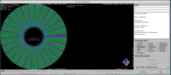

Next step is to load the .RAW Images into the HxC Software by setting up the .RAW Parameters as shown
in the attached Step-1.png file. This will be a SS/SD IMAGE.
Once the .RAW file is loaded, Double check the settings as shown in Step2.png, Step-3.png, then Step4.png.
Now, the File is ready to be exported as shown in Step-5.png & Step-6.png, so EXPORT a *.IMD file that will boot.
For a SS/DD Image select the settings as shown in Step-7.png.
This should clear up and confusion about why HxC defaulted to the improper setting, which I did not double check.
