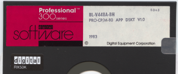

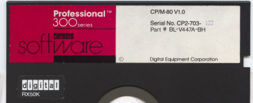

I was able to acquire one of these devices but the only known support diskette images (teledisk) are corrupted. These were originally posted to the Retro-Computing Society of Rhode Island's now-defunct web site so I'm hoping someone associated with that group (which still appears to exist) can unearth and re-image the media. I've seen folks from the RI Computing Museum on this forum and am hoping someone can help. Thanks!
Here's a photo of the diskettes and a Wayback Machine image of the original page where the bad images were posted.PRO_CPM-80.jpg
I have images of these disks, but judging by what my ImageUtils writes about errors in the FS, these are the same broken images.
If your images are cpm-{1,2,3}.td0 then they are indeed broken. I'm hoping someone at RICM can unearth the original media. John Morris (Applesauce) took a dive into the .td0 files and reached the conclusion that they're hopelessly corrupted. All checksums are good, but the reads were apparently garbage - perfectly preserved garbage - but garbage nonetheless.
As for hopelessly damaged, I would argue, but whether they can be completely restored is most likely not.
