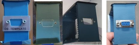

I started on the Metalwork. I made a D9 connector template from some pcb material . First I drilled the holes and tapped them with a 4-40 UNC thread. It is an interesting business tapping threads in aluminium, It is better to do it a little incompletely with a Taper tap and then run a Roll Form Tap through it, it compresses the threads and they become much stronger.
The 1/4 inch 20 TPI mounting hole for a Tripod tapped directly into the base is not wonderful, because the metal wall, excluding the internal ridges is only about 3.3mm thick, so with about 0.8 turns/mm that only provides about 2.6 turns of thread. That could, after screwing the Cyclops to a few tripods start to wear out pretty quickly. I bought the taps for that including a Roll Form tap but I'm still considering it or modifying that arrangement.
Th thread for the lens is not too bad as it is finer. I'm awating for that Tap from China. One option I'm considering is using the D to C mount adapter, they will drop into a 25mm plain hole and the front flange thickness is only 0.5mm and they have a perectly cut D mount thread in material that is 4.6mm thick and they could be secured by a pair of screws, rather than the C thread.... still deciding on that one. I might Tap the thread for the lens and see how well that goes , I can always bore the holeout to 25mm and go to the C-D adapter to provide the thread if there is an issue.
Also, from what I can tell it looks like they glued metal strips onto each aluminium side panel of the case. I will have to prepare those and a label.
