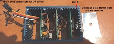

I have been slowly assembling the camera head. I cut out a stainless steel mirror plate to help reflect the light from the LED's back onto the sensor chip, probably better than Alfoil. I used the single connectors to plug onto the D9 connector's pins, because that way I can easily take the 3 boards out of the housing for diagnostics servicing etc, without having to unsolder the wires from the connector Still waiting for a number of parts, including the Tap to make the thread for the lens.
