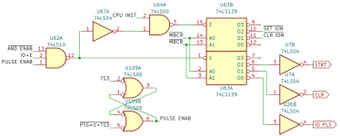

As far as I can tell, the "P" pulse refers to a special pulse used for interacting with I/O devices. When a No I/O Transfer instruction is sent, which device it applies to depends on the last 6 bits of the instruction. Device code 0 refers to the CPU, and is sort of a dummy instruction. The decoding for that goes nowhere, and presumably for moments where the CPU needs to test itself like this (see U63B pins 9 and 12).
We never see the ION signal set at any point, which is good because we shouldn't.
P is just another signal you can send to the device (along with S and C). Not used a whole lot (most notably used to initiate a seek or recalibrate on a disk drive), but given there were 2 bits available so that decodes into 4 possible options...
Device 77 refers to the CPU. There is no device assigned to device 00. Test A10 is verifying that u64A is not stuck at a 0 output...
Okay, we may have found the point of failure, and it's upstream of the part being explored per post #101.
This N8271 shift register is used to store a bunch of states as we progress through processing. The signal we care about is how IO*E is generated from IO(F+D). Presumably, that data is loaded in every time PTG5 is asserted (processor time group 5)
So why is IO*E changing when PTG5 is not being asserted? We're not using the serial function, so that can be ignored. The reset would presumably clear that value, not set it, so how exactly is that happening?
The cyan trace should only change with the blue trace, and it's changing whenever it feels like it.
We're also seeing suspicious signals down the line that are triggered from IO*E. Look at the rise time spikes on IO*E on U62A, with rather slow ramp-up. Plus, there are negative going spikes out of U62A when edges cross in some ways that feel like we shouldn't be seeing any changes. But I think this could explain why we're never seeing U63B's O0 ever pulse low like we expect to. Now I just need to find my spare N8271's...
I'm still not clear how exactly the CPU logic test is determining that this failure is occurring, but whatever. We'll get there.
Do you think it's shifting rather than holding? Looks like the serial in is floating, which we've seen previously results in a high level. So suppose pin 13 is not properly grounded - if it floats from time to time (e.g., due to a bad solder joint), then it looks like a high level to the chip and will do a shift regardless of the state of the Load input...
