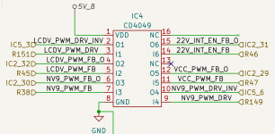

If any PWM signal is missing, the power supply shuts down after about a few dozen milliseconds and the red LED flashes, despite correct voltages on the rails. All PWM signals pass through the CD4049 circuit.

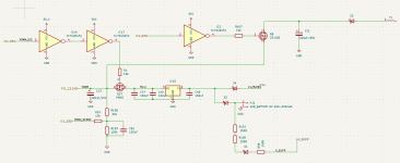

@silence012 In the message above, I made a small mistake because I was writing from memory — the internal power line is 22V, not 18V as in the T1600. Below is the part of the schematic responsible for generating the 22V voltage. There may still be some minor errors; if you find anything, please let me know so I can correct it. V+ (MAIN) is 12V.
Additionally, below is the part responsible for the VRAM voltage.Zrzut ekranu 2025-11-17 o 09.13.27.png
@silence012 I have completed the schematic, although I don't yet know what all the signals mean. However, the rest should be correct. I am posting the schematic in a thread that seems more appropriate for powering up the T1200XE.
