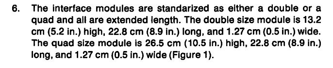

Third question - can someone direct me to the relevant spec for height limits on the Qbus boards? I obviously would need to select appropriately sized electrolytic caps if possible.

I think they were asking about the maximum height of components on the board. See these attachments for drawings which include component height limits.
yes, the maximum height was what I was after, as the sequencer card mentioned has a pair of electrolytics that are HUGE in relation to the allowable space.
The second attachment I uploaded shows a limit for double-width cards. I wonder whether that sequencer card fits within the double-width spec, or would occupy more than two card slots?
In the original application, it was set apart from the rest of the slots, because of the caps and the presence of 28VAC on the board.
Looks like a pair of miniature SMPS modules would be a better bet than staying with the 7805 / 7912 (and relocating the AC input away from the backplane).
