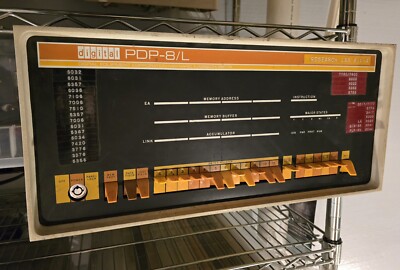

Sorry if this is a duplicate post, but I didn't see any other:
DEC PDP 8L Very Rare but Most Popular in late 1960s
