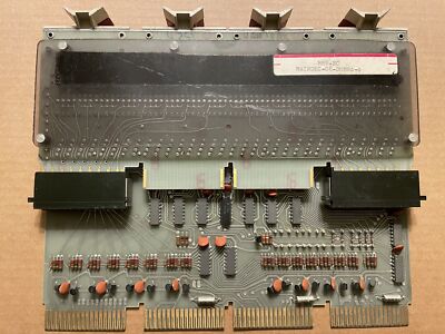

Signetics N8881N on ebay:
Ebay
“Item condition: New, old stock.”
This may be of interest for some of us? I bought some and my LEAPER says PASS.
But I have not used them yet, came today.

Thanks for the tip. I've bought one lot. For that price I can take the risk :) It might be interesting to test a chip under load. I have a few originals in stock, so I can compare them...
Regards, Roland

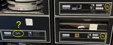

That is a lot of stuff. The 8/e in the right cabinet doesn't have any memory or processor cards, that much is obvious. I can't identify any of those boards from the photo but no top block connectors means none of those are multi board controllers like an RK8E. It is really tough to say if this is a good value. My gut feeling is that it is probably worth the asking price but it would be nice to see detail of the card loadout in both 8/e chassis.
It's the DECtape transport and RK05 drives which would tempt me if I had enough cash to burn on it, even if the 8E's best bits have been plundered.
what's going on with the RK05 drive numbering? The two RK05J have RK05F-style drive numbering and the RK05F has four drive numbers? It gives the impression we're looking at removeable double-density RK05J's and a 'quad density' RK05F?
The RK8-E controller could only address unit 0 - 3. The RKS8-E (or RK8-L) controllers could address 0 - 7.
Does anyone recognize that half-size controller in the bottom of the full rack? FTI logo? Maybe Forward Technology Inc.? maybe Multibus boards?
Could it be a 'special' controller that somehow doubles the storage density of the RK05's? Or maybe it really is just a collection 'for parts'.
Interesting. Maybe the drives are split in smaller parts for an os which didn't support the full size? Or split so every user had its own part?
It's the Fabri-Tek logo. It's gotta be a core memory expansion system. Bitsavers shows the Model 8 for the 8/I and 12 which looks virtually the same, but perhaps they made an Omnibus one, too.
OS/8 can only handle a device with up to 4095 blocks (of 256 12 bit words). A removable RK05 exceeds this (6496 blocks) so it was split into two smaller devices of size 3248.
My understanding is that he RK05F, because it had a fixed platter was able to operate at twice the track density so it would need to be at least four devices (a little over 3 full size devices actually) from an OS/8 standpoint.
I don't have an OS/8 handler source (or binary) for the double track F version in my collection.
That is true, but the RK05J is split into A and B parts under OS/8 with just one drive select number. The RK05F responds to two drive select numbers, with each split into the A and B parts.
Maybe they used a special OS/8 device driver that didn't use the A and B parts of a single drive select number, and used two OS/8 drive numbers for each drive select number?
That A/B construction is exactly the reason why I thought about something else than OS8...
I agree, there may be other than OS/8 software here. Can you read the label on the middle pack? I think it looks like MULTOS SYSTEM
Thanks to antiquekid3 for identifying the FTI logo. It seems bizarre to adapt a PDP-10 8K - 36-bit core plane to provide 24K of 12-bit memory for an Omnibus system.
