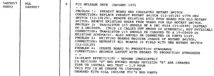

It is a reasonably clean bare bones machine with 8k of core and a M8650 serial interface. Change a few jumpers to boost the baud rate on the serial interface and I could boot OS/8 via Console Serial Disk.
The front-panel is for the original reed-relay display selector rotary switch that did 180 degree travel. Newer models used a mechanical contact rotary switch with an updated front-panel silk screen to match the ~170 degree travel.
The M8320 (bus loads / terminator) board has the ECO that replaced the transistors in a DIP package with three discrete (T05 case) transistors.
Interesting solution to use Douglas Electronics replacement for the M935 Omnibus jumpers.
It has the front painting of the 180° version, but the position of the switch looks more like 170°. And from the pictures I cannot see the reed relais or the switch.
I also like and prefer the smooth switching of the reeds. Do you know when they changed the design?
