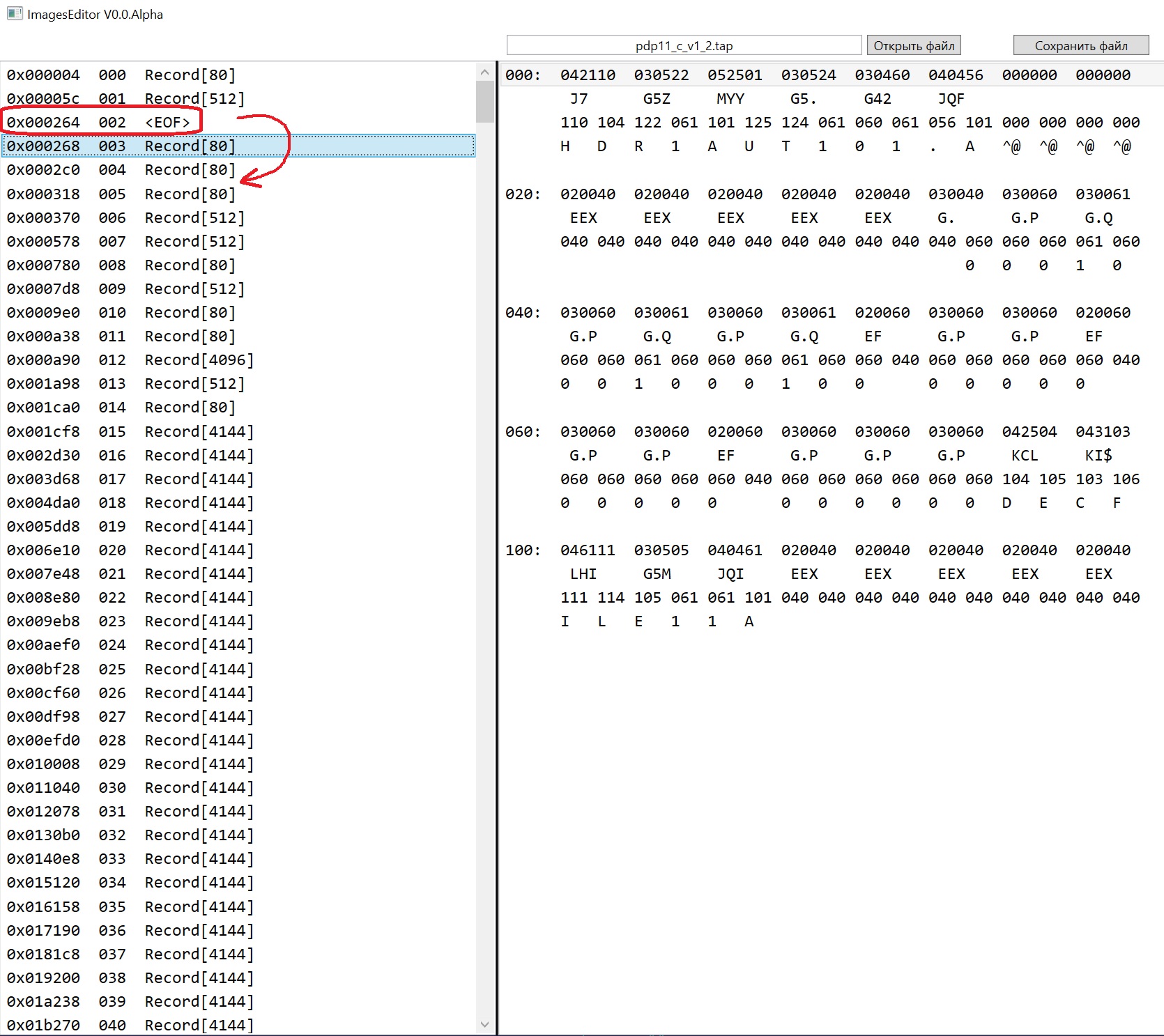

There is an images of tapes on bitsaver, created with an error - swapped blocks. Somewhere I came across information - due to an error in the image creation program, which occurs during repeated readings on faulty parts of the tape.
Some time ago, the idea was maturing - to write a program that helps to restore such images - was embodied in the alpha version 0.0 of the ImageUtils program.
So far, all the program can do is open a tape image, show the contents, swap blocks and save the image after editing.
Restored (95 percent - its help) the DEC RSX C 1.2 distribution
Enough functionality - rearrangement of blocks
Lacked functionality - it was necessary to create an EOF2 block (at the end of the tape image) - FAR came to the rescue and knowledge - what is in EOF2
Here
Assistant :) and one of the changes
