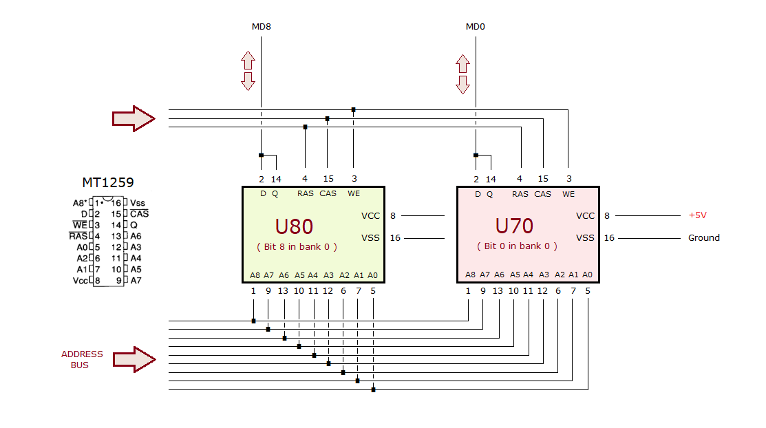

I have been checking all connections between the ML1259 chips with my multi-meter and I have noticed that all pins on the 16 pin MT1259 chips are linked except for pins 2 and 11 is that correct?
The MT1259 RAM chips being the ones in bank 0.
Good: Pin 2 is the data pin. So, pin 2 of the bank 0 chips are expected not to be connected together.
Bad: Pin 11 is address bit 4 (A4). Therefore, I expect that pin 11 of all bank 0 RAM chips be connected together. Surely at the least, some are connected together. Recheck this. If there was an A4 problem, and it was the only problem, I would expect the 'AT version of RDR' to pass the 'Check first 2KB of RAM' test, and then go to fail the address test.
But maybe there are multiple problems. You are seeing something unexpected in regards to A4 in bank 0, and so that needs to be investigated. For example, are you not seeing continuity between pin 11 of U83, and
pin 11 of U84 ?
I do not see any point.
pin 11 of U84 ?
Sorry its pin 2 & pin 14 that have no connection between each chip.
That's better.
And what you may see is that on each chip, pin 2 (data in) is connected to pin 14 (data out). Where that may not be the case, is on the parity chips. Confirm the pin-2-to-pin-14 connection on the data chips for me.

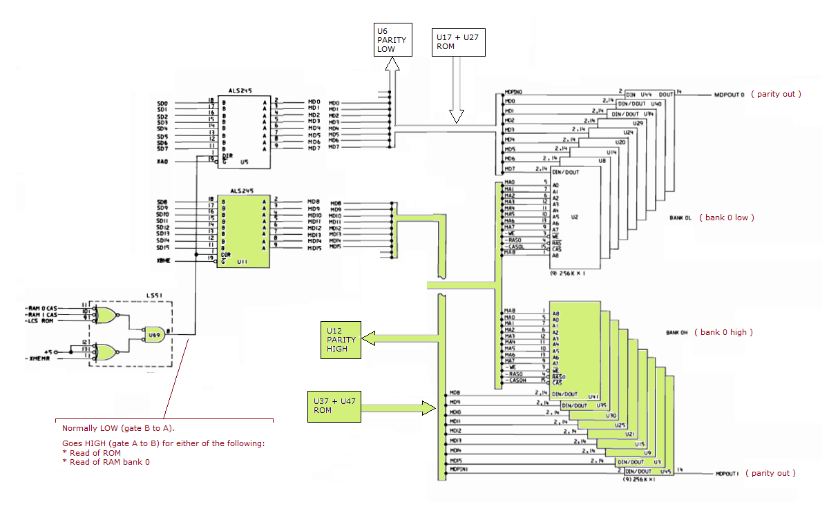

In the IBM 5170, there are two CAS signals for bank 0:
• CAS-0-L for the low byte of bank 0, targeting pin 15 of each RAM chip in the low byte of bank 0
• CAS-0-H for the high byte of bank 0, targeting pin 15 of each RAM chip in the high byte of bank 0
I.e. The 'pin 15's of the low byte of bank 0 are not connected to the 'pin 15's of the high byte of bank 0.
But on your motherboard, you implied that the 'pin 15's of all 16 RAM chips in bank 0 are connected together. That would differ to the IBM 5170. Please verify what the story is in regard to your pin 15.
Back to the IBM 5170 diagram. For the symptoms, what I would suspect is:
• Faulty U5
• Faulty generation of CAS-0-L
• Open-circuit between the DIR pins of U5 and U11 (i.e. direction signal reaching U11, but not U5)
• XA0 not reaching U5
But not having the circuit diagram for your Dell motherboard makes things tricky. What you could do is see if there is an equivalent to U5 on your motherboard. That is, does pin 2 of U70 connect to one of the A/B pins of a 74245? If so, try replacing the 74245 (observing correct replacement, e.g. 74ALS245 for 74ALS245, etc.)

I enhanced the 5170 diagram. It turns out that the BIOS ROM's are on the memory data bus. So for the symptoms on a 5170, the possibilities would be:
• A problem in the generation of CAS for the low byte of bank 0.
• The ROM supplying the low byte is always outputting its data, resulting in bus contention, and always wining the contention 'war'. (Faulty ROM, or good ROM always commanded to output).
But not having the circuit diagram for your Dell motherboard, we don't know where in the circuitry the ROM's are. To see if they are on the same data bus as the RAM, see if there is continuity between the data pin of U70 (U70 = bit 0 of low byte of RAM) and the data 0 pin (pin 11) of whichever BIOS ROM (27C256's in your Dell) is supplying the low byte.

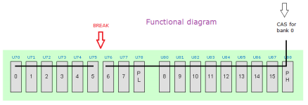

I have just spent ages going along the 2 rows of RAM chips (U70-U78 and U80-U88) checking that all pins from one chip to the next are connected for pins 1 to 16 except pins 2 and 14, I found a lot of missing connections between some chips and where there was no connection I linked between the 2 chips with a small bit of wire creating a connection. The Chips that had no connection were Chips U73, 74, 75, 76 and U77.
The Ram chips at the end of each row are U94 last chip in row 1 and after U78. Then U95 is last chip in row 2 and after U88. The last in row chips dont follow the same connection pattern as the other chips. Maybe these are the Parity chips you mentioned.
anyway I turned the dell on and here is a screenshot of what your diag Rom reported. i would think what Ive done has cured a lot of ram errors from the last diag check.
Sorry forgot to do this for you. I get continuity between pins 2 & 14 on every Ram chip except on U25 & U28.
The 2 74LS245 chips on my motherboard are U85 & U43. There is no continuity between U70 pin2 and any pins on the 74LS245 chips.
also pin 2 of U70 does not show any continuity to any pins on the 2
There is no continuity between pin 2 of U70 and any pins on the 2 Bios roms (27C256's)

No apology required. I had a colonoscopy, and there were some other local matters to deal with. This is a hobby.
Comparing that screenshot to the one in post #24, bits 7 and 6 are now working. It throws out the hypothesis that a certain chip failure was impacting on the entire low byte of bank 0.
If in bank 0, we compare one of the working bits, bit 8, with one of the faulty bits, bit 0, we end up with the diagram at [here].
Let's look at U70.
U70: You have verified (from working bits) that pins 2 and 14 are connected together.
U70: Apart from the data pins (2+14), all other pins (including VCC {+5V} and VSS {ground}) on U70, connect to the corresponding pins on working chips.
Therefore, I think that the data pins (2+14) need to be investigated.
I see three 74LS245, U54 being the third. It's next to ISA slot 6.
Note that your motherboard uses part of a chip set, the CHIPS and Technologies CS8220. Taking a look at that chipset:
- A data sheet for the chip set is at [here].
- In the data sheet, the block diagram reveals that the 82A205 chip, acts as the buffer between the SD bus and the MD bus. (IBM 5170 diagram at [here].)
Can you confirm that pin 2 on U80 (working bit) is connected to one of the pins on the 82A205 chip. There is a pin-out of the 82A205 on page 3 of the aforementioned data sheet. Expected is that the 82A205 pin used is pin 2 (MD8), but for all we know, Dell may not have used direct pin mapping.
If that connection exists, see if pin 2 on U70 (not working bit) is connected to the 82A205.
Have you re-seated the 82A205 ?
I get continuity between pins 2 & 14 on every Ram chip except on U25 & U28 is this correct?
checked all pin 15 connections and this is what I found:
there is continuity between pin 15 on U70 to U75
and U94. But there is no continuity between U75 & U76 (Do I need to put a link between U75 & U76?) but there is continuity then between the remaining chips U76 to U78 and U95
On the second row there is continuity between U80 to U88 & U95.
Pins 2 and 14 are DATA IN and DATA OUT. When I look at the RAM diagram at [here], I do not see a U25 nor U28.
If you meant the parity chips, U78 and U88, then that is not unexpected. It comes down to the design. For example, in the IBM 5150, per [here], the data in/out pins are connected on each parity chip. But in the IBM 5160, per [here], the data in/out pins are not connected on each parity chip. If U78 and U88 are the chips you meant, then I think we can safely deduce that in the System 200 design, Dell has the data in/out pins pins disconnected on each parity chip.
You have quoted U94 and U95. Those are in bank 1. We are only interested in bank 0 at this time.
Pin 15 is the CAS pin on an MT1259. In bank 0 (chips U70 to U88), all chips should have pin 15 (CAS) connected to each other. And so it sounds like you have found the cause of the current symptom of 'bits 0 to 5 in bank 0 are faulty'. Yes, connect pin 15 on U75 to pin 15 on U76.
Thats it sorted I believe, check the screenshot of RDR. I dont understand how i didnt notice the break in the circuit between U75 & U76 when I checked all the other Ram chip connections. It might have been due to auto multimeter I had that kept giving me unreliable results so I threw it out and used a old cheap meter and got consistent results straight away. So much foe some modern expensive meters.[/quote]
