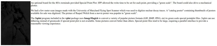

I have attached a Tektronix Storage Tube Terminals pdf file I made from archive.org's capture of Chuck Forsberg's (Tektronix program manager for 401x terminal development) OMEN website that described the Flying Spot Scanner and 2splot program (part of vplot package) which could use dithering instead of greenscale if special point plot is not available.
It looks like the Racquel Welch plot was done in dithering mode.
I brightened that Racquel image for better viewing - still not very clear:
