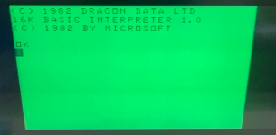

I made a din scart cable and finally I managed to get a decent enough signal..Unfortunately this Dragon has some problems...the basic writings are wrong and if I press any key, what appears on TV does not correspond. I checked all eight RAMs with the oscilloscope and I do not see blocked signals...

What screen do you initially get when your turn the machine ON? Let's work from that end.
It is not too far out:
So you should be able to work out which characters work and which characters do not and look at the bit differences between the two values (in ASCII). This is the same thing we did on a PET - but in PETSCII. Do you remember the tables?
I worked that out from the start-up screen I just posted above.

I don't, because there are only eight (8) of them and BASIC appears to be working (albeit the hardware is displaying incorrect characters). If a RAM was faulty, you probably wouldn't get the screen that you are getting, because the 6809 CPU would crash. The characters that are displayed are systematically incorrect...
I would poke around here:
Schematics: http://www.dragondata.co.uk/tech/circuit-diag/index32.html.
Good manual to read: https://colorcomputerarchive.com/repo/Documents/Books/Dragon/Inside The Dragon (Duncan Smeed and Ian Sommerville).pdf.
The 6847 (IC12) is the video generator and contains an internal 64-character character generator (when using 512 bytes of main memory (from memory address $0400 to $05FF). It looks like the data is latched from the DRAM to the video generator by means of IC13. It would be sensible to scope the Qn outputs of IC13 feeding IC12.
As a quick off-hand analysis, it's not just a stuck bit. If it were, I'd expect either T (%0101 1000) or F (%0100 0110) to display, but not both (bit 4 is different between the two). Yet O (%1000 1111) also turns into F. So bit 3 is sometimes working, sometimes not.
You definitely have a problem with Q1, so I would start there.
A -> @ (Q1 in error (LOW)).
C -> B (Q1 in error (LOW)).
E -> D (Q1 in error (LOW)).
G -> F (Q1 in error (LOW)).
I -> @ (this indicates a problem with both Q4 and Q1 - but let's worry about Q1 for now).

Pin 6 and 12 of IC13 they are stuck low!
Maybe IC13 is faulty.
But I would test the input pins (Dn) first before you warm up the soldering iron!
The Q1 output is driven by the D1 input.
Likewise the Q4 output is driven by the D4 input.
