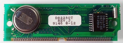

I recently picked up several of these…because, you know, I don’t have enough projects.

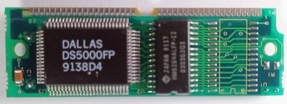

These are from 1991 and the CPU is a DS 5000 variant of the 8051. Packaged with 8K of RAM (as program and data memory) and an RTC, all made non-volatile by that battery. The CPU can run at 12 MHz. All of this on one small board – almost a complete micro.
The carrier board is not made by DS and I am only just beginning to trace it out and see exactly what it is for. It’s easy enough to see the crystal and caps and the reset circuit. I also see the pull-up resistor packs connected to the bit switches. Not sure what the two empty sockets are for. One seems to be for a buffer and is attached to the four LEDS.
I have only just begun to follow the traces and I am starting with the 20 pin connector marked as MODEM.

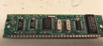

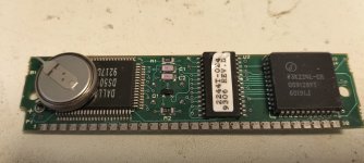

Ha, I gave away a few years boxes full of DS2244 modules I bought many many years ago on a HAM swap meet.
I still have a few of those. The DS5000 on those is very nice. It relies totally on the battery though since program is stored in SRAM.
Benefit of that is that you can reprogram them endlessly. The DS2244 also had a modem onboard and a DTMF decoder as well as an RTC.
These modules were probably used for remote monitoring/control purposes (over a telephone line). The batteries were all OK still after so many years. Probably due to the extreme low power demands of the RTC (in deep sleep) and the Sony SRAM.
To program the board you need to pull up/down one line which gets the CPU into serial monitor mode. There you can send a few commands to up/download the firmware and to set the division between program and data memory. I must have the original DOS software for this somewhere... It was kindly send to me by someone at Dallas along with a datasheet which stated 'confidential' or such :-)

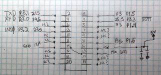

So, I started tracing out the 20 pin connector labelled MODEM on the Arbitron HCV38 carrier board.
Qualifier: I could have mistakes, follow at your own risk.
This is enough to power up the board and try to get to an "It's Alive" moment. But for now, I want to think some more about it. Note the capacitor pair on the +5 in line.

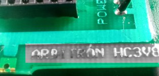

But I am curious why it says ARBITRON on the board. The ratings people? (now owned by Nielsen) Not that I wouldn't expect them to have a use for something like this, it could be useful to have battery backed RAM to store a few days of TV watching data. And everything being in RAM means they can easily erase and reload it for the next deployment.
Good Questions.
It definitely says that on the board.
For years, Arbitron was a part of Control Data Corporation (CDC) and in 1992, it became a part of Ceridian Corporation before the company was split in 2001 (from here) .They certainly made plenty of Gizmos. The seller said that the DS2250Ts were new but the carrier boards were not. They arrived in sealed bags. The unused, but usable, edge connectors suggest that it was a component board/part.
