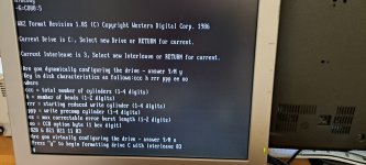

Sorry for the delay in responding ( sometimes analogue life takes some time too ) .
This part is WORKING !!
I used the wd eprom , and all worked flawlessly .
Now to get something decent on the harddrive so the testing can begin.
