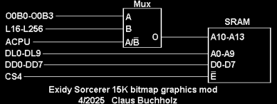

The Sorcerer has 128 user-defined characters in 1K of SRAM. That's great for most games which use tiled displays but it's not enough to cover the whole screen with arbitrary graphics.
I have some 16Kx4 SRAMs which are mostly pin-compatible with the original 1Kx4 chips, so I plugged them in along with a mux chip to drive the 4 extra address lines. During video access, those lines come from the video line counters. During CPU access, they come from a parallel output port. In this prototype, it's the keyboard scan port. So the bitmap display consists of 15 1K banks at the normal addresses FC00 - FFFF. The software paints the screen with 15 copies of the user character set and then it switches banks and fills each with a slice of the image. This test image is a monochrome BMP of Wikipedia's photo of a Sorcerer.
The Z80 runs at 2.1 MHz. Loading a 12K .BMP file into main RAM takes 7 seconds at 20 kbaud with my TapeSim. Then the 36-byte loader program uses 12 LDIRs to render it in less than 0.2 second.
I have not written any line drawing or fill routines yet.

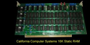

Imagine what such an upgrade might have been like in 1979. 30 1Kx4 SRAM chips plus a few logic chips. Maybe 2/3 the size of an S100 board.
It could have plugged into the rear expansion port. And some ribbon cables with dip headers to tap into the display SRAM sockets. It might have cost $400, half the price of a Sorcerer.
By 1982 it could use 2Kx8 SRAMs and be small enough to fit inside the case as a daughter board. Maybe $200 then.
